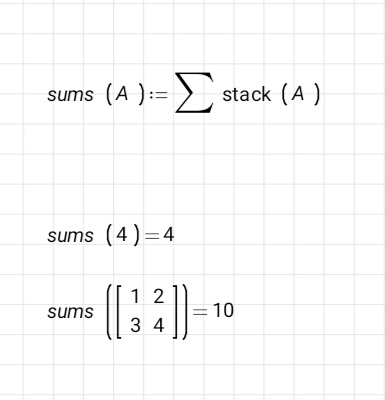

Note that using the stack approach you don't need the zero

Ha! :d :d That's puzzling! You can "stack" nothing on something!
