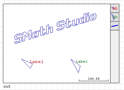

Hello, please someone knows how to rotate text in modeller region?
WroteHello, please someone knows how to rotate text in modeller region?
Hi. This is a workaround, based on https://en.smath.com/forum/yaf_postst20332_Drawing-Text.aspx
DrawingTextModeller.pdf (104.58 KiB) downloaded 832 time(s).
DrawingTextModeller.sm (278.08 KiB) downloaded 1544 time(s).

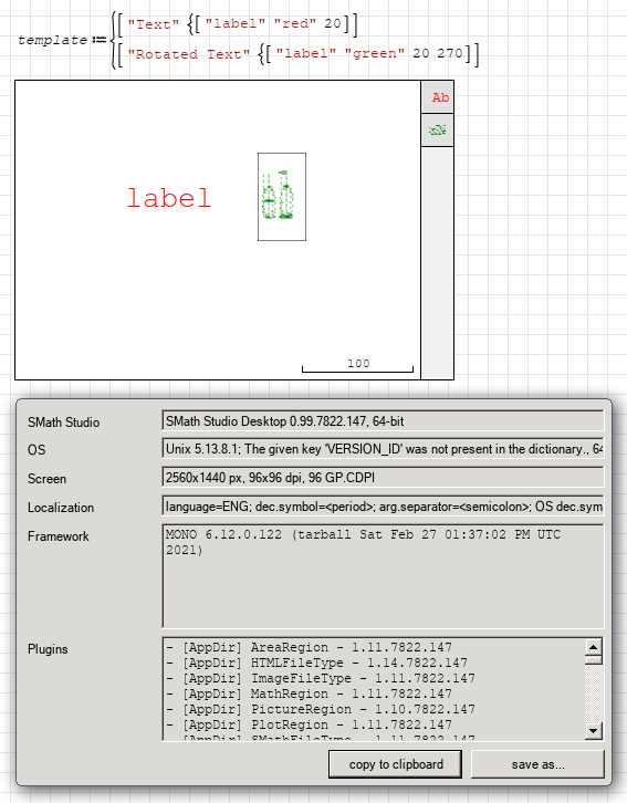

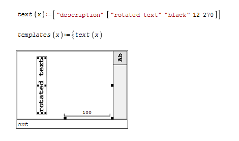

WroteUse 270 as 4th argument to rotate 90° counter-clockwise
Text Rotation in modeller region with 270 as fourth argument is not working under Linux.
I had encountered this several months ago, maybe years. Forgot to report it.
WroteText Rotatior in modeller region with 270 as fourth argument is not working under Linux.
I'll look into it, thank you.
Thanks Davide for rotated text in Modeler.
modeller Rotate Text.sm (177.71 KiB) downloaded 1567 time(s).
