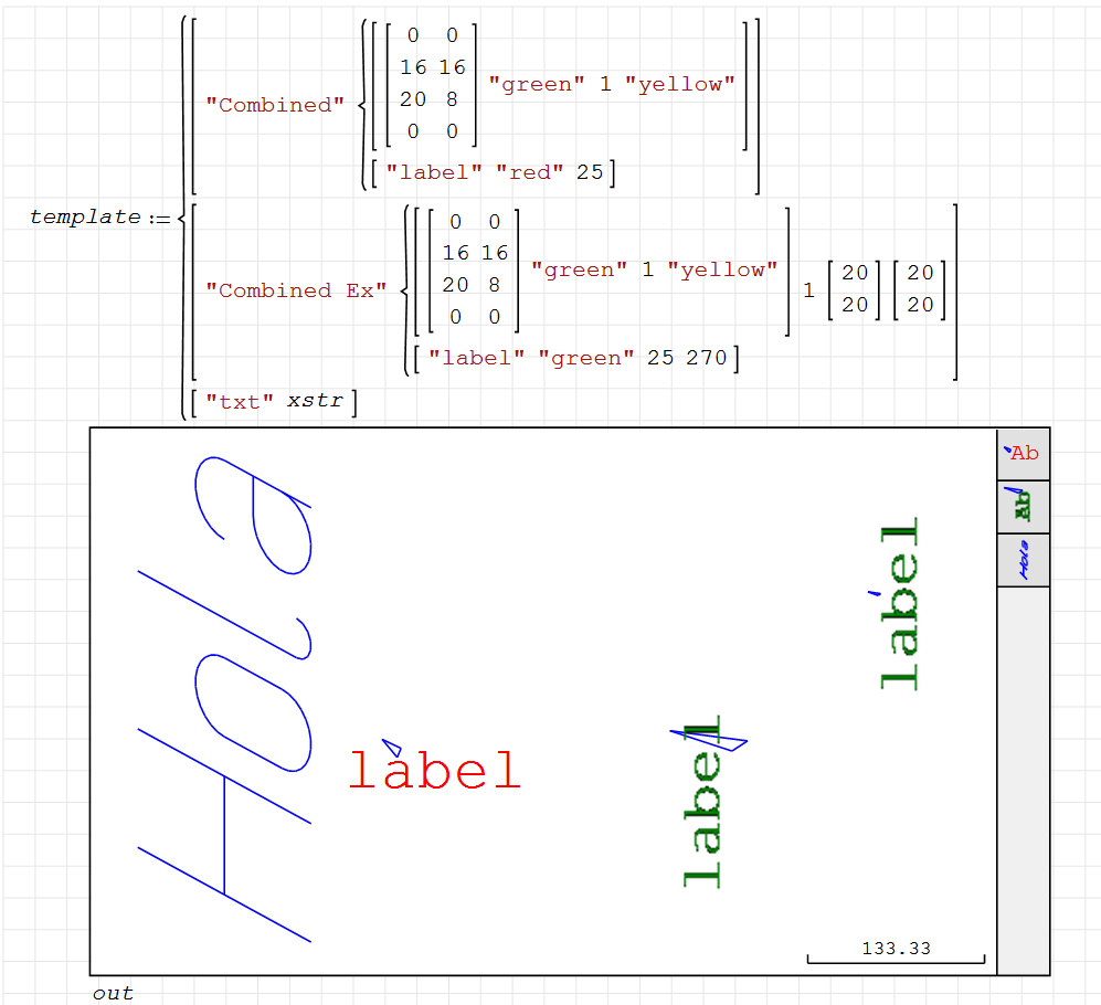

#65 Опубликовано: 08.08.2021 14:26:40
Renzo Choque
Renzo Choque
6 сообщений из 18 понравились пользователям.
Hello, please someone knows how to rotate text in modeller region?
Hi. This is a workaround, based on https://en.smath.com/forum/yaf_postst20332_Drawing-Text.aspx
DrawingTextModeller.pdf (104,58 КиБ) скачан 987 раз(а).
DrawingTextModeller.sm (278,08 КиБ) скачан 1776 раз(а).
Thanks Alvaro, your implementation is very interesting, but I would like to know how to rotate the normal text (green label) without distorting it.

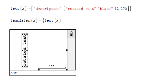

#66 Опубликовано: 10.08.2021 07:59:32
Use 270 as 4th argument to rotate 90° counter-clockwise
Jason McCool 10.08.2021 11:38:00, Oscar Campo 10.08.2021 11:54:00

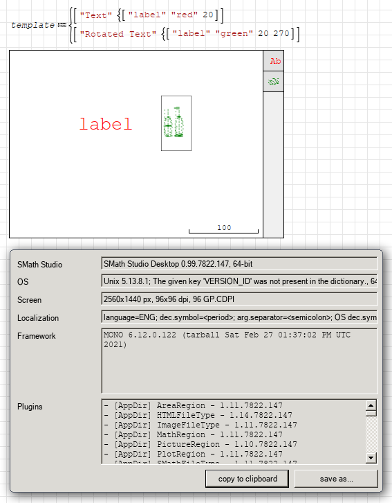

#67 Опубликовано: 10.08.2021 12:54:54
Text Rotation in modeller region with 270 as fourth argument is not working under Linux.
I had encountered this several months ago, maybe years. Forgot to report it.
#68 Опубликовано: 11.08.2021 05:34:50
Text Rotatior in modeller region with 270 as fourth argument is not working under Linux.
I'll look into it, thank you.

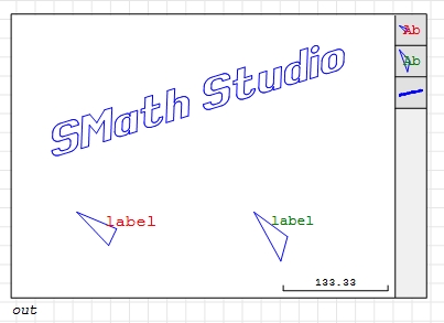

#70 Опубликовано: 12.08.2021 14:53:06
This is how it is rendered with rotated text.
