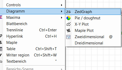

Hello, Smath friends,
the plugin 3dPlot must always be reinstalled.
Become 3DPlots are displayed and can be changed.
After the SMath update to 0.99.7005 I can't find
a menu item 3Dplot in the submenu / diagram anymore.
Copying 3DPlotdigagrams and changing them works.
This is annoying and quite cumbersome. Who can please
help me ?
Many thanks

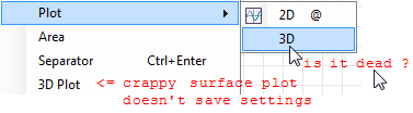

You mean the 3D surface plot is gone ?

Thank you very much for your answer,
I mean the plugin 3DPlot , which I use again and again with every
Program start must be reinstalled. I now have the
Beta version 0.99.7016 installed. After the program start
it must also be reinstalled, but appears as menu item
in DIAGRAM. I can live with that. Unfortunately "forgets" SMath
the plugin again and again. Maybe there is another solution.
What about if you click on the Maxima menu icon.
Maybe it is in there whereas 3DPlot is a Maxima ?
Can't help more ... in short: you have lost 3DPlot
or some of additional plotting capability past SS 6179.
#5 Posted: 2019/3/19 15:42:35
2,315 likes in 3,949 posts.
If program asks to update plugins after the new version installed then please do this. This dialog means that SMath Studio cannot work correctly with old versions of listed plugins.
And yes, it will ask you to update plugins again and again after every single start.
You need to make a choice:
1) To use new version of SMath Studio with updated plugins;
2) Use new version but delete listed plugins (dialog allows you to remove them);
3) Use old SMath Studio version with old plugins.
