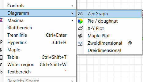

Hello, Smath friends,
the plugin 3dPlot must always be reinstalled.
Become 3DPlots are displayed and can be changed.
After the SMath update to 0.99.7005 I can't find
a menu item 3Dplot in the submenu / diagram anymore.
Copying 3DPlotdigagrams and changing them works.
This is annoying and quite cumbersome. Who can please
help me ?
Many thanks

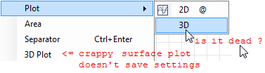

#2 Posted: 3/18/2019 12:57:38 PM
You mean the 3D surface plot is gone ?

#4 Posted: 3/19/2019 3:41:44 PM
I mean the plugin 3DPlot
What about if you click on the Maxima menu icon.
Maybe it is in there whereas 3DPlot is a Maxima ?
Can't help more ... in short: you have lost 3DPlot
or some of additional plotting capability past SS 6179.
