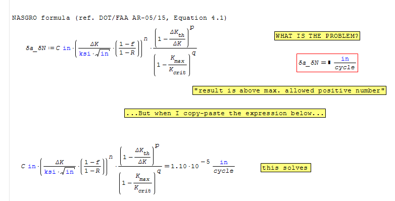

I have an error message that I can't figure out.
For the most part, I have been able to learn Smath on my own, despite the absence of any user manual, and only a few brief tutorials written by users themselves (Liengme and Urroz).
If there are any deeper manuals to recommend, I would be very happy to see links to them.
I am still relying very heavily on my long experience with Mathcad to pick this up - but it's a double-edged sword because Smath doesn't do all that Mathcad did.
One thing I would like is a list of error messages and their meaning. I can't find any references to this error expression on the SmathStudio website/forum. I could probably solve this for myself if I could find one. If I have missed an important source of information, I'm sorry, but please point me to the right place.
The file linked below is part of a very long analysis that's suddenly gone bad on me - no idea why.
Only the parts before the strange error are included. The rest is very very long.
Thank you (in advance) to everyone that can help.
I've also included a screen-capture of the offending expression:
ERROR.sm (76.88 KiB) downloaded 1083 time(s).

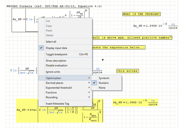

Another solution is to put the equation in numerical optimization mode,
and the error is eliminated.

Wow,
Thanks to everyone for your help.
Firstly, I'm surprised that there's a simple solution to the expression that would not solve. It looks like I can globally select all the fields on a math page together and make sure they are all set to "numeric" just to make sure I haven't accidentally toggled something.
Not that I am clear on just what "symbolic" is for... presumably if I play with "symbolic" expressions I can get Smath to simplify an expression? If I was a math teacher, or a student, I can see how that would would be fun or helpful.

4. Unless the project is naturally all "Numeric" compatible, you have to
consider Symbolic/None as applicable by part. By default, a new work sheet
is in Numeric mode.
