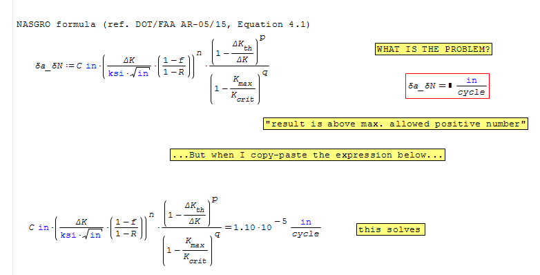

I have an error message that I can't figure out.

The file linked below is part of a very long analysis that's suddenly gone bad on me - no idea why.
Only the parts before the strange error are included. The rest is very very long.
Thank you (in advance) to everyone that can help.
I've also included a screen-capture of the offending expression:
ERROR.sm (76.88 KiB) downloaded 1238 time(s).

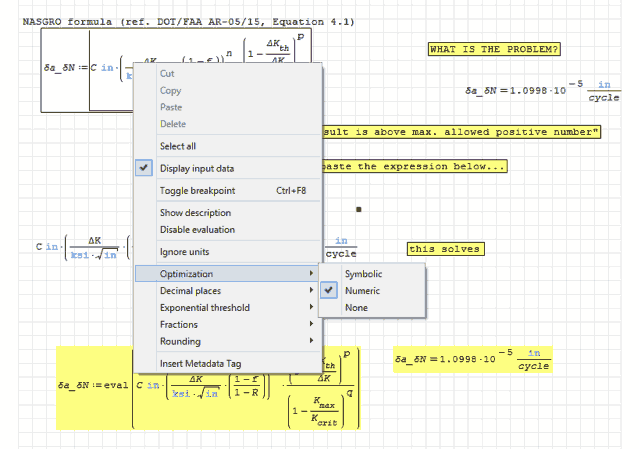

Another solution is to put the equation in numerical optimization mode,
and the error is eliminated.
ERROReval_r1.sm (82.09 KiB) downloaded 1244 time(s).

Firstly, I'm surprised that there's a simple solution to the expression that would not solve. It looks like I can globally select all the fields on a math page together and make sure they are all set to "numeric" just to make sure I haven't accidentally toggled something.
Not that I am clear on just what "symbolic" is for... presumably if I play with "symbolic" expressions I can get Smath to simplify an expression? If I was a math teacher, or a student, I can see how that would would be fun or helpful.

4. Unless the project is naturally all "Numeric" compatible, you have to
consider Symbolic/None as applicable by part. By default, a new work sheet
is in Numeric mode.
