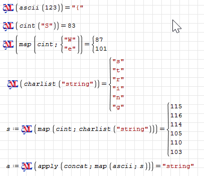

Is there a method within SMath for converting between strings and vectors of Unicode Points (or ASCII codes)? That is, a means of accomplishing what Mathcad's str2vec and vec2str do?
#2 Posted: 2025/9/21 21:15:09
1,308 likes in 2,221 posts.
You can use Maxima.
string.sm (5.5 KiB) downloaded 527 time(s).
Edited 2025/9/21 21:16:32

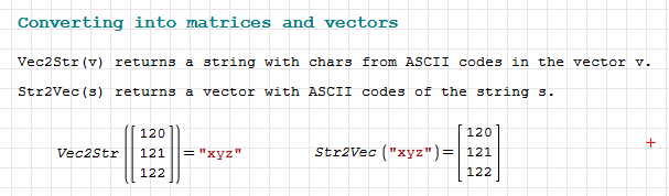

#3 Posted: 2025/9/22 00:33:10
1,078 likes in 1,749 posts.
Hi Stuart. Nice to read you. You can use the functions in this post: https://smath.com/en-US/forum/topic/bppdgC/String-utilities, which, while not very efficient, at least get the job done.
