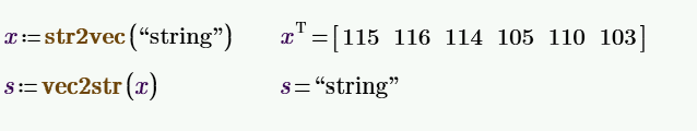

Is there a method within SMath for converting between strings and vectors of Unicode Points (or ASCII codes)? That is, a means of accomplishing what Mathcad's str2vec and vec2str do?

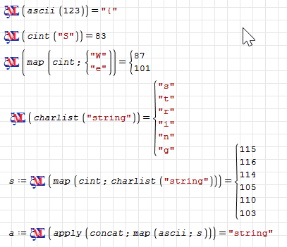

#2 Опубликовано: 21.09.2025 21:15:09
You can use Maxima.
string.sm (5,5 КиБ) скачан 1306 раз(а).

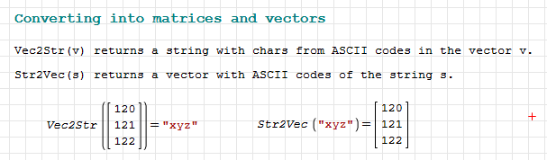

#3 Опубликовано: 22.09.2025 00:33:10
Hi Stuart. Nice to read you. You can use the functions in this post: https://smath.com/en-US/forum/topic/bppdgC/String-utilities, which, while not very efficient, at least get the job done.
