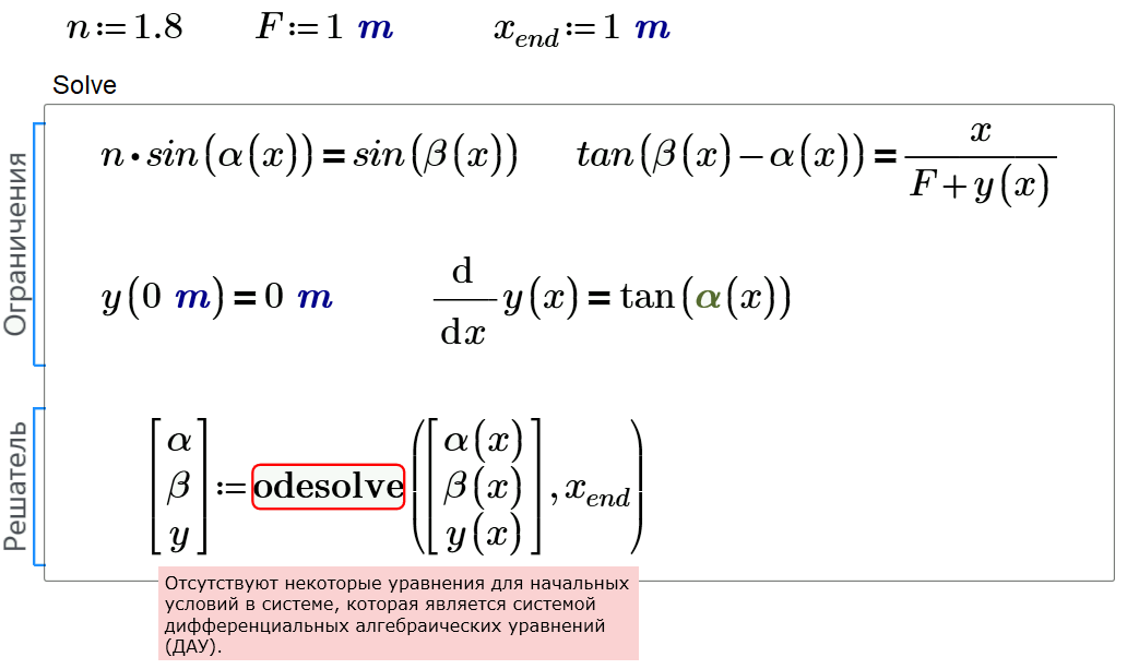

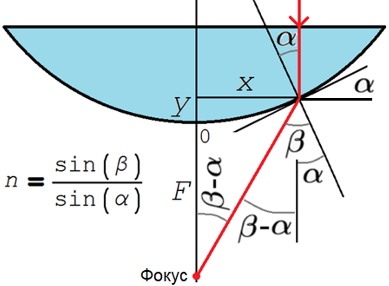

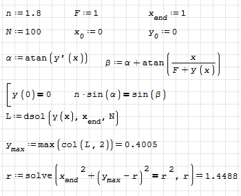

How can we use here a Mathcad-block?
Lens-Mathcad-Block.sm (43.8 KiB) downloaded 1036 time(s).
See too
https://en.smath.com/forum/yaf_postst25212_Lens.aspx

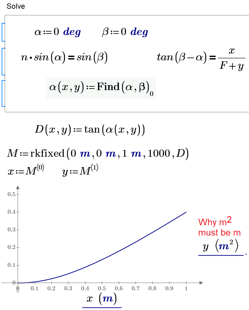

#2 Posted: 2024/12/1 18:08:12
1,532 likes in 1,838 posts.
Here the function rkfixed() can't process the incoming expressions correctly. The block has nothing to do with it, it does not perform detailed analysis of expressions.
This is a bug in the function. The function has not been tested for this case. I can't see what's wrong here right now.
Valery Ochkov 2024/12/2 15:44:00
#3 Posted: 2024/12/1 19:52:45
1,308 likes in 2,221 posts.
This is not a solution of the rkfixed problem, just a little playing around with X-Y plot.
Here, an option of setting the aspect ratio of the axes to 1 would be good.
Valery Ochkov 2024/12/2 15:45:00, francesco rapuano 2024/12/3 04:21:00

I am wondering if there is such a kind of Mathcad Prime odesolve for solving differential equations numerically also for SMath Studio somehow?
#6 Posted: 2024/12/8 01:21:21
Valery Ochkov
Valery Ochkov
64 likes in 670 posts.
Not yet, but will be soon!
Question - why is the answer meters squared, and not just meters?
What's wrong with the existing solvers?
Because odesolve in Mathcad Prime:
1. Do not require to rewrite the differential equation of a higher order into a system of first order odes
2. Determines whether a system is stiff or nonstiff and then is using accordingly the stiff numerical differential eq solver or nonstiff numerical differential eq solver
3. Can solve numerically a system of differential equations (whatever it's a system of first order differential eq or a system of higher order differential eq)
What are these existing numerical solvers of differential eq in SMath? What are the posibilities of SMath to solve numerically differential equations? Exist at least one solver that mimic the Mathcad Prime odesolve (i.e. the 3 points above menționed)?

Hi Cornel. For points 1 and 3, SMath can do what Mathcad can, and just a little more. Please, check the first post in this plugin. Can mathcad solve this odes?
RKA.sm (308.62 KiB) downloaded 1280 time(s).
RKA.pdf (931.16 KiB) downloaded 871 time(s).
About point 2, one would have to review the documentation for the following plugins to see if they are capable, and to what extent, of doing what you are asking, and choose it for the solver in the SMath's solver block.
● [topic=17088]Intel ODE Solver Library[/topic]
● [topic=1918]DotNumerics[/topic]
● [topic=13809]SADEL[/topic]
● [topic=1970]Matlab C++ Math Library[/topic]
● [topic=17063]OSLO[/topic]
● [topic=17067]lsoda[/topic]
● [topic=1997]GNU Scientific Library (GSL)[/topic]
#10 Posted: 2024/12/8 08:58:47
1,078 likes in 1,749 posts.
See too
Hi. dsol can solve it with this setup:
RKA-Lens.sm (179.91 KiB) downloaded 996 time(s).
I also use the Martin's setup for the plot.

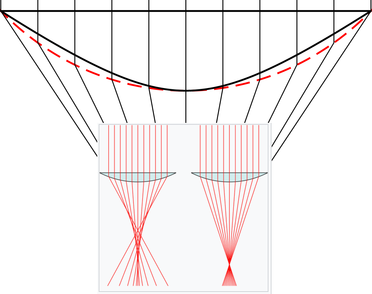

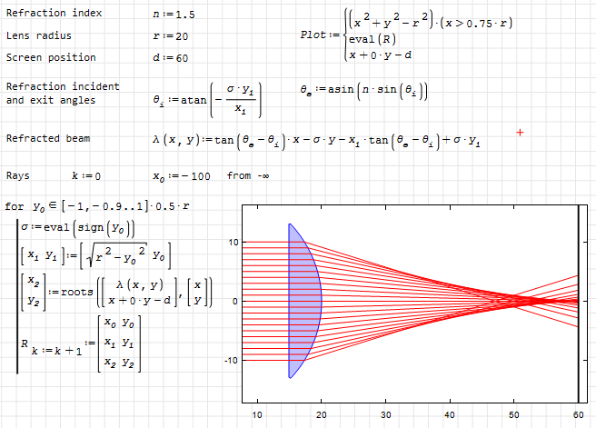

How to create this picture
https://en.wikipedia.org/wiki/Spherical_aberration
#12 Posted: 2024/12/10 04:11:05
Hi Valery. This is a way.
spherical aberration.sm (15.88 KiB) downloaded 987 time(s).
Oscar Campo 2024/12/10 09:43:00, Valery Ochkov 2024/12/10 12:26:00
#13 Posted: 2024/12/10 12:38:25
Valery Ochkov
Valery Ochkov
Thanks!
The last step
#14 Posted: 2024/12/10 21:21:41

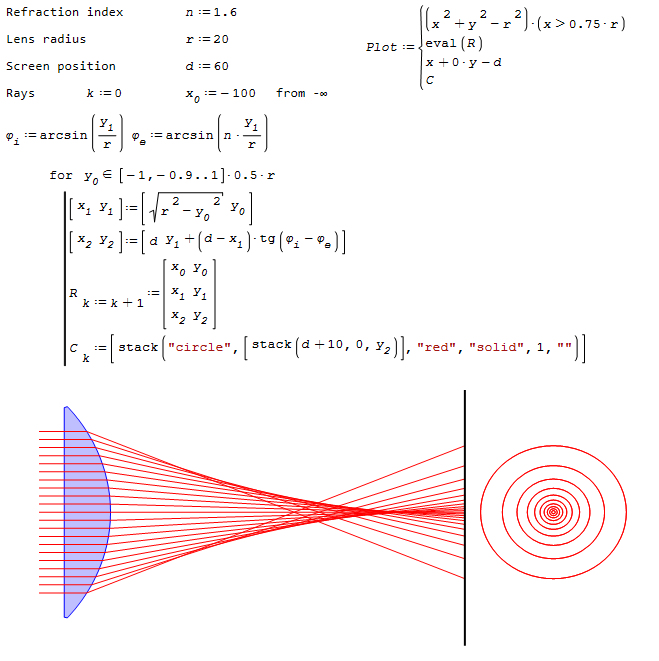

Hi. The screen. I also simplify a little the calculations.
spherical aberration.sm (26.41 KiB) downloaded 1135 time(s).
francesco rapuano 2024/12/10 23:05:00, NDTM Amarasekera 2024/12/10 23:16:00, Вячеслав Мезенцев 2024/12/10 23:19:00
#15 Posted: 2024/12/10 21:35:39
Oscar Campo
Oscar Campo
135 likes in 309 posts.
Very elegant solution

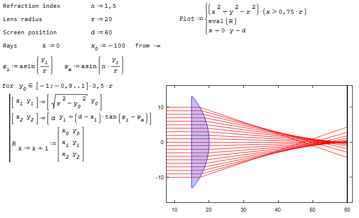

#16 Posted: 2024/12/11 03:06:13
Root-free version of the spherical lens
spherical aberration_Kr.sm (12.37 KiB) downloaded 958 time(s).
Alvaro 2024/12/11 06:18:00

#18 Posted: 2024/12/12 04:49:07
Oscar Campo 2024/12/12 18:29:00, Alvaro 2024/12/13 07:27:00
