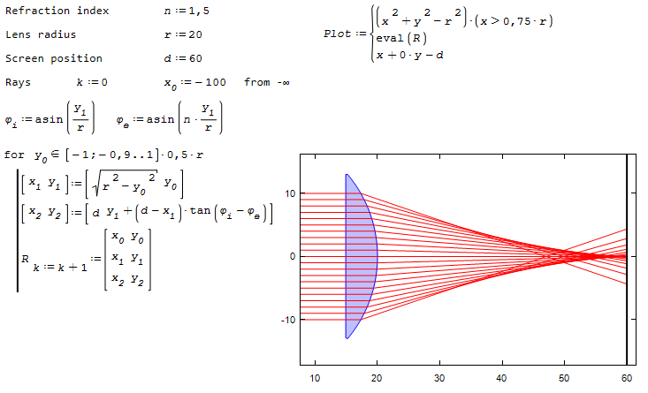

Hi Cornel. For points 1 and 3, SMath can do what Mathcad can, and just a little more. Please, check the first post in this plugin. Can mathcad solve this odes?
RKA.sm (308,62 КиБ) скачан 2252 раз(а).
RKA.pdf (931,16 КиБ) скачан 1719 раз(а).
About point 2, one would have to review the documentation for the following plugins to see if they are capable, and to what extent, of doing what you are asking, and choose it for the solver in the SMath's solver block.

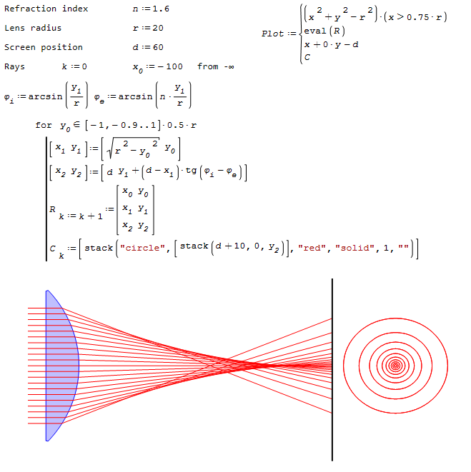

Hi. dsol can solve it with this setup:
RKA-Lens.sm (179,91 КиБ) скачан 1810 раз(а).
I also use the Martin's setup for the plot.

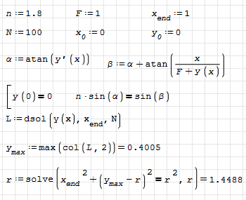

The last step
#14 Опубликовано: 10.12.2024 21:21:41
Hi. The screen. I also simplify a little the calculations.
spherical aberration.sm (26,41 КиБ) скачан 1949 раз(а).
francesco rapuano 10.12.2024 23:05:00, NDTM Amarasekera 10.12.2024 23:16:00, Вячеслав Мезенцев 10.12.2024 23:19:00
