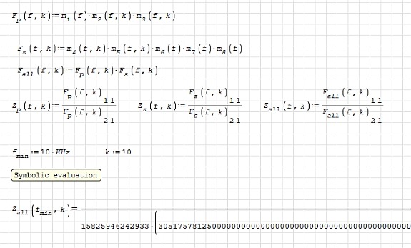

hi,
I'm a beginner
I get an error in the calculation
error :
result is above max. Allowed positive number
How can I solve it?
impedance.sm (34.02 KiB) downloaded 1036 time(s).

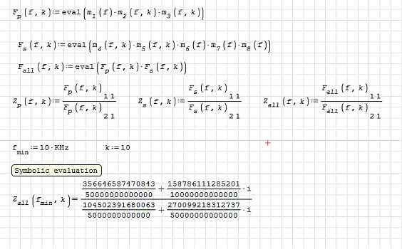

Change your calculation result from symbolic to numeric.
You can do it with eval() since they are all numbers.

eval() is a general rule but an absolute rule.
Many projects fail from eval(,).
SS 6179 does not complain as you constructed.
eval(,) is applied afterwards to isolate/accelerate.
#5 Posted: 2021/5/28 20:33:21
Good application case to globalize within the program.
... in my SS 6179 timing drops from 2.6 s down to 1.6 s

Hi Takez. Yes, it's very difficult recognize or even guess where the program needs some evals. Also, putting them everywhere make unreadable the procedures. In the case of your PPS.sm that's SMath stores into Z without eval
and this with it
So, for PPS.sm there is where you need to use eval, and seems that then all other calculations works.
