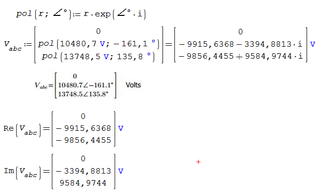

I am one tiny step away from freeing myself of Mathcad Prime. I just need to know how to format the result of a matrix/vector operation so it is in polar form with angle in degrees. The attached image is a snip from a Mathcad result. How is this possible in SMath?

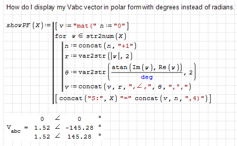

#4 Posted: 2025/10/14 09:09:21
1,123 likes in 1,795 posts.
Hi. You can try something like this, using the table plugin.
showPolarForm.sm (18.3 KiB) downloaded 930 time(s).

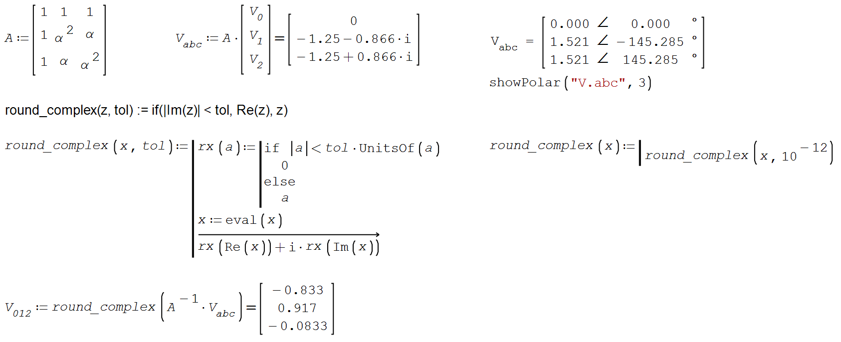

#5 Posted: 2025/10/14 18:04:28
Russ Patterson
Russ Patterson
0 likes in 5 posts.
Thank you. That works rather well.
1) Is there a way to hide that showPF function at top of my worksheet?
2) I can't figure out how to make it report a very tiny imaginary component as zero. See bottom of attached. showPolarForm.sm (20.74 KiB) downloaded 952 time(s).

#7 Posted: 2025/10/14 22:59:16
Hi. Modified version.
showPolarForm.sm (21.93 KiB) downloaded 983 time(s).
sergio 2025/10/15 17:42:32, Russ Patterson 2025/10/15 20:51:43
#8 Posted: 2025/10/15 20:51:58
Russ Patterson
Russ Patterson
0 likes in 5 posts.
Outstanding! thank you
