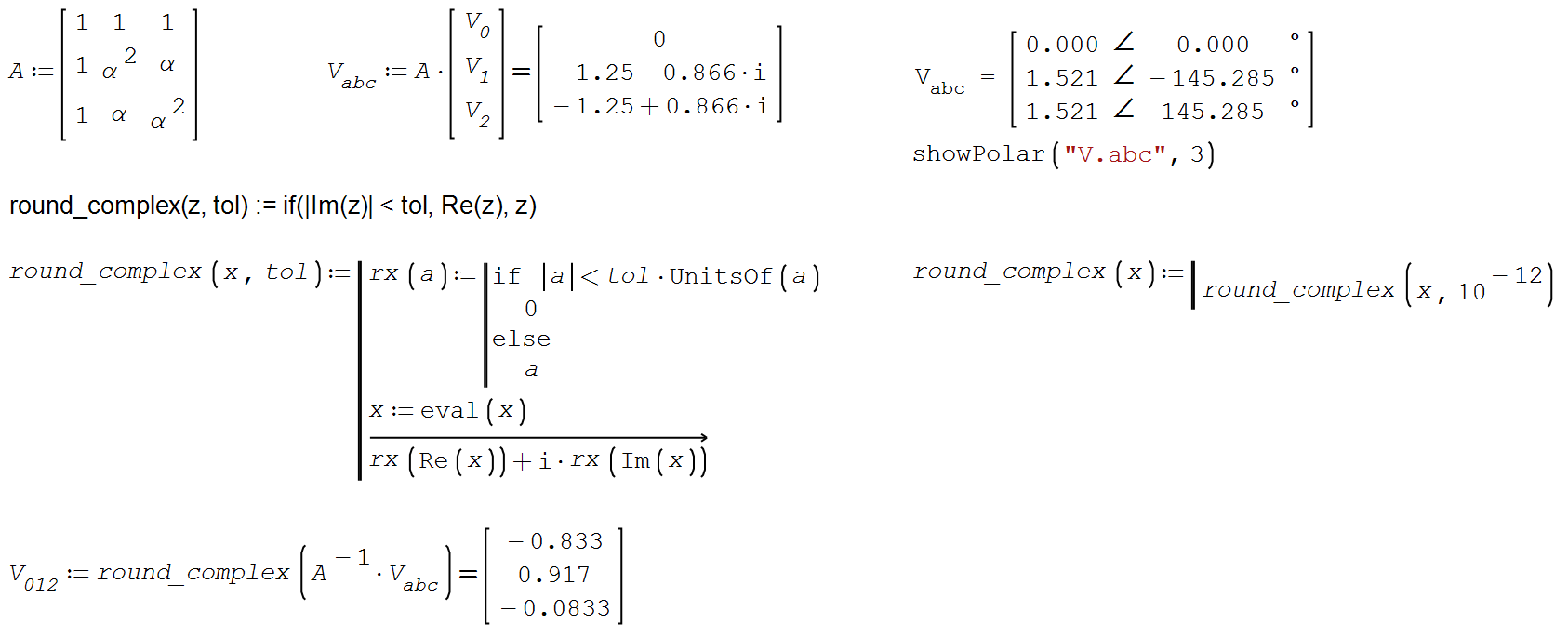

I am one tiny step away from freeing myself of Mathcad Prime. I just need to know how to format the result of a matrix/vector operation so it is in polar form with angle in degrees. The attached image is a snip from a Mathcad result. How is this possible in SMath?

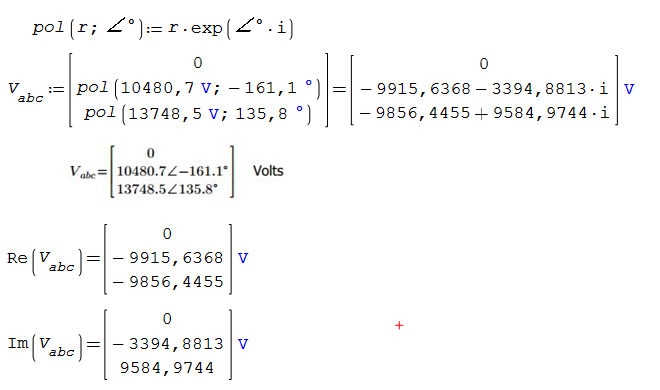

Thank you. That does not address formatting a vector result in polar with degrees (what I'm after) as best I can tell. I want to display my resulting vector in polar with degrees.
Also, I tested the "pol" function and it assumes the angle is in radians.
Worksheet1.sm (10.64 KiB) downloaded 1114 time(s).

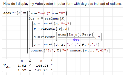

#4 Posted: 10/14/2025 9:09:21 AM
1,139 likes in 1,805 posts.
Hi. You can try something like this, using the table plugin.
showPolarForm.sm (18.3 KiB) downloaded 1150 time(s).

1) Is there a way to hide that showPF function at top of my worksheet?
2) I can't figure out how to make it report a very tiny imaginary component as zero. See bottom of attached. showPolarForm.sm (20.74 KiB) downloaded 1179 time(s).

#6 Posted: 10/14/2025 6:27:56 PM
127 likes in 342 posts.
1) Menu --> Insert --> Area. Place the functions you want to hide between the two lines. Then click the little square with the – sign to collapse the area."
