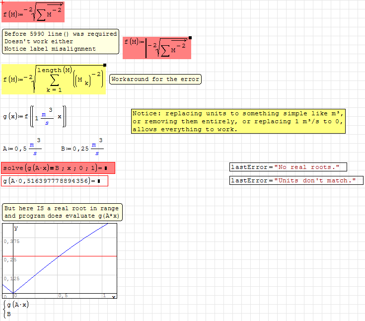

#4 Posted: 2016/5/26 23:22:43
Mike Kaganski
Mike Kaganski
184 likes in 434 posts.
solvQerr.sm (9.17 KiB) downloaded 1571 time(s).
С уважением, Михаил Каганский

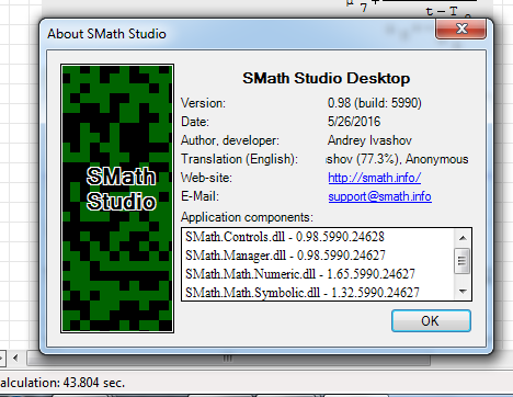

#7 Posted: 2016/6/1 16:02:08
Ruben Sidranski
Ruben Sidranski
17 likes in 465 posts.
I found a bug in this version. Took over 5 minutes before I terminated the file. I took a snapshot with the timer running (shows 43 seconds) after Jean confirmed 5 seconds on his machine using version 5346.
Is this supposed to take over 5 minutes to calculate? May be SMath as this is the second sheet today that "locks-up" with the calculation tool bas and the timer running
Re-download in case something got wrong in the transmission.
XP Home, 1.8 GHz, Smath 5346 OFFicial release => 5 seconds
Inst_Viscosity Water.sm (52.14 KiB) downloaded 1691 time(s).
Would be interesting more collabs test the timing, thanks.

#11 Posted: 2016/6/2 22:24:20
Yes, but is this truly SMath bug? Or some extension's? Did you try to investigate before writing "I found a bug" to the New Smath Version advertisement topic?
I have no maple/maxima on my system, could that be a thing?
======================= I read you Mike ===========================
1. It may be a problem with local machine/OS ... conflict with others [I doubt].
2. Maybe with the Maxima solve block: solve(μT(t)-q(t),t,2,30) => disable the solve block.
3. Maple is not invoked in this attached document => eliminate Maple
4. With the symbolic Ah ! but only Smath symbolic.
-------- Thiele continued fraction Smath symbolic down to the plot => 4.5 sec
-------- Thiele continued fraction Smath numeric down to the plot => 0.5 sec
A thiele continued fraction calculates bottom to top [24 Aops ... Arithmetic operations]
This Thiele in Smath symbolic is in the range of 8 pages wide, my count 326 Aops
The μ350(x) is a J_Fraction equivalent to the continued fraction still existing in Maple.
It reduces the Aops [in this case down from 24 to 13. It computes faster as well as reported in C.T. Fikes [IBM of years 70]. I think I still have the algorithm of J_Frac,
in case some of you developpers would be interested.
The rational fractions [typical normalised Padé style] are expandable in J_Fraction,
but here again: Smath symbolic expands in horrible mess as the continued fraction.
The Newton-Wallis method is a way to compute continued fraction top to bottom.
My brain has diluted on this, maybe Mathcad as well.
Now, whoever wants: test and report versions to versions.
Cheers, Jean
Forum Compute Test.sm (25.07 KiB) downloaded 1557 time(s).

#14 Posted: 2016/6/3 03:17:53
Oh ! there is another point, most important, like this: Some "modern users" have dual core, quadruple core.
That kills the compute engine [slows down]. There was a Mathsoft collab crying about Mathcad 11 takig minutes
to calculate a work sheet with his bomb dual core that mine, steam engine, computed in fraction of second.
#15 Posted: 2016/6/3 11:33:41
