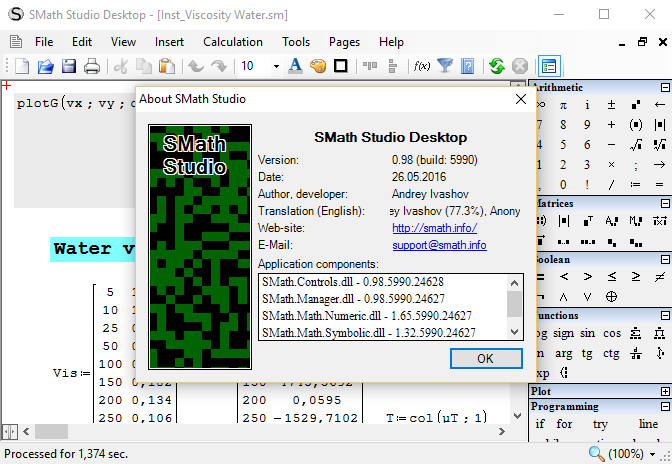

WroteWroteIs this supposed to take over 5 minutes to calculate? May be SMath as this is the second sheet today that "locks-up" with the calculation tool bas and the timer running

Still seems like a computational bug. Mine went 5 minutes before I closed it down

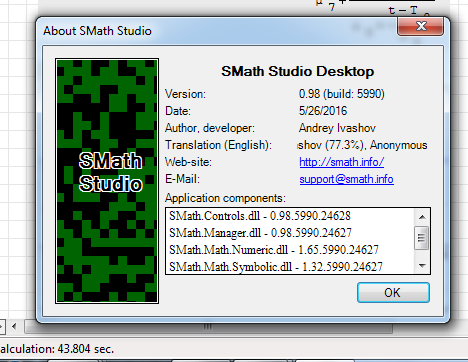

That was partial answer. I just upgraded to 5997 and there was an update to the Maple V wrapper. System went 14 seconds before I terminated it. I disabled the plugin and it took .98 rev 5997 0.760 seconds to process. Andrey fixed something in the new version as I was over 14 seconds with Maple disabled before. Sorry for not being clear before.WroteYes, but is this truly SMath bug? Or some extension's? Did you try to investigate before writing "I found a bug" to the New Smath Version advertisement topic?
