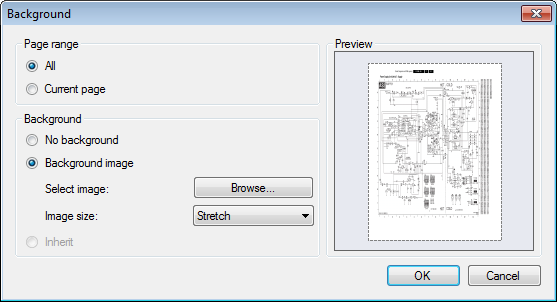

As for now the only way to setup such things is to use a background (Inset > Background > Background image)

The background image (f.e. containing the logo or the title block) can be extended to any page, dynamic items such as the page number are accessible only in the header/footer.
