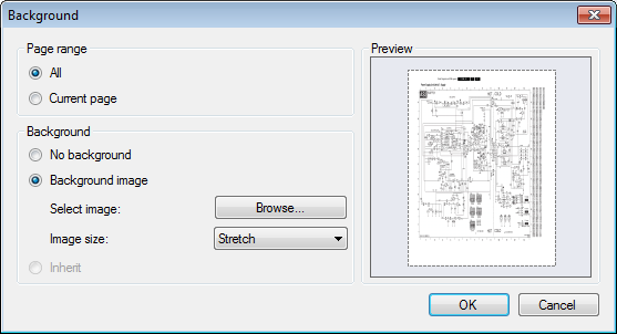

is it possible to create typical page layout? For example with my own header, page number etc?

As for now the only way to setup such things is to use a background (Inset > Background > Background image)

As I understand there is no possibility to add it automatically on each page, therefore I will have to add it manually each time?

The background image (f.e. containing the logo or the title block) can be extended to any page, dynamic items such as the page number are accessible only in the header/footer.
