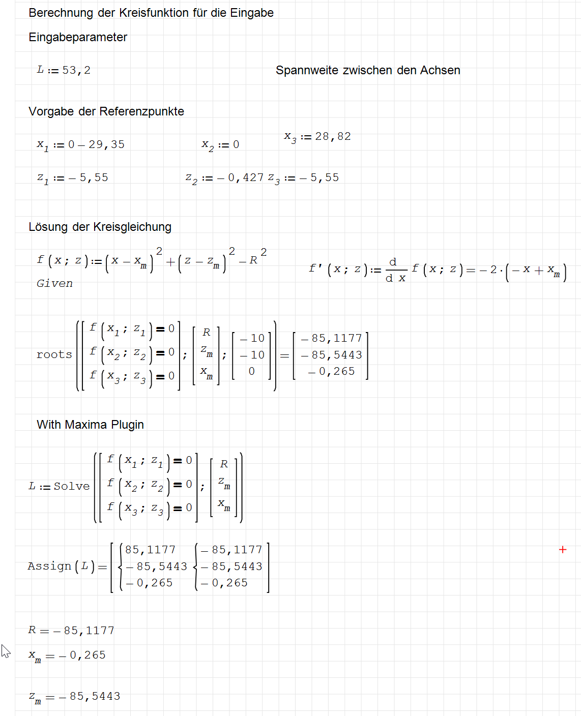

Im trying convert this mathcad solver to smath but it doesnt work.

It is a non-linear system. With the internal "Roots" solver it is appropriate to use initial values ​​sufficiently close to the result.
You can use some of the smath plugins that are more robust. For example, with "Solve" of the "Maxima plugin you get the result.
Show Spoiler
Radius_318a_ser.sm (337.14 KiB) downloaded 765 time(s).

With an addition to sergio's solution;
You can use vectors while solving.

Solution with another solver.
al_nleqsolve.sm (6.99 KiB) downloaded 669 time(s).
