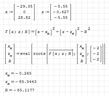

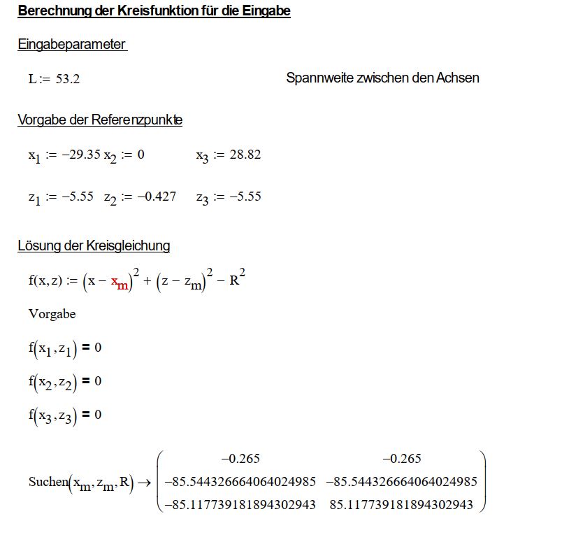

Im trying convert this mathcad solver to smath but it doesnt work.
Radius_318a.sm (9,34 КиБ) скачан 1284 раз(а).

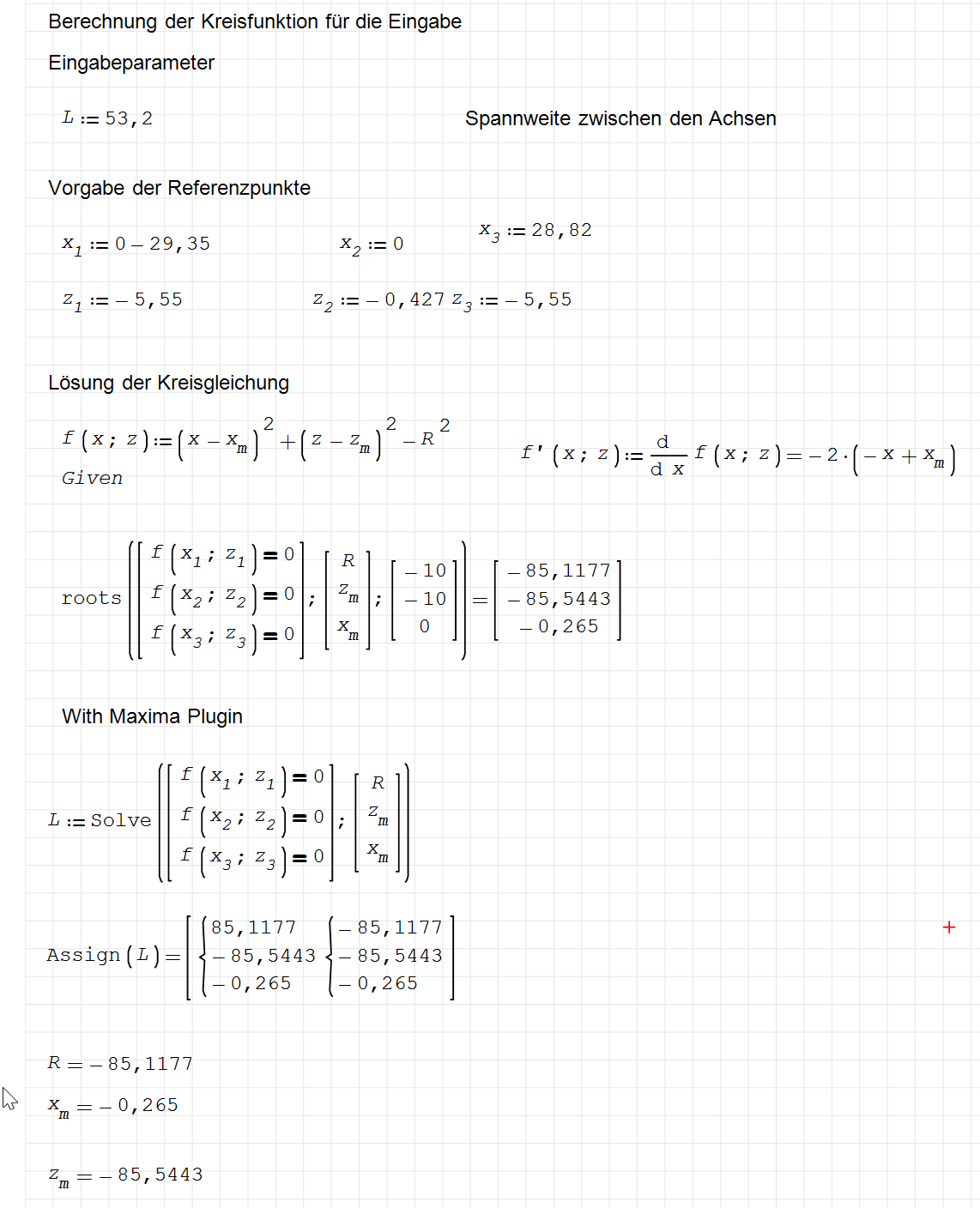

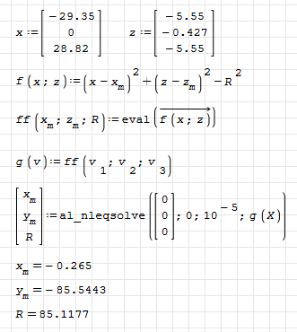

It is a non-linear system. With the internal "Roots" solver it is appropriate to use initial values sufficiently close to the result.
You can use some of the smath plugins that are more robust. For example, with "Solve" of the "Maxima plugin you get the result.
Radius_318a_ser.sm (337,14 КиБ) скачан 1359 раз(а).
