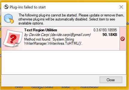

The update for "Text Region Utilities" is OK now.
WroteThis this works fine. Thank you!
You're welcome, thank you for reporting this issue
WroteBut there is a problem with "Text Region Utilities" plugin to install.
Thanks again; updated both the plugins (added another small performance improvement for print preview).
