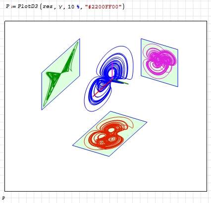

Hi. For show the four plots at once.
DadrasAttractor.sm (46.22 KiB) downloaded 1060 time(s).
Fridel Selitsky 2021/7/27 03:46:00

Thanks for the 3D image
