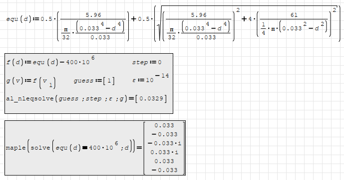

Hi all,
I am trying to solve an equation with the unknown "d". I have attached my Smath file and hope someone can help me with this.
Thanks a lot.

In times of these, al_nleqsolve() is your friend.
Or you can use maple or maxima solvers.
NoRealRootsError_solved.sm (8.97 KiB) downloaded 1072 time(s).

Why does the equation needs to be re-written to f(d)? And what's the reason f(0) has to be calculated? How do I need to interpetret the things below the graph? I am sorry but it looks like magic to me

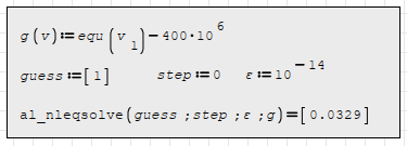

Hi overlord, thanks for your help.
Could you elaborate on what is described in the grey area?
Why did you re-write the equation to f(d)? And why is in the equation f(d) equ(d) added?
What is the function of step:=0?

Sorry, coming back on this. What is the meaning of 0.033*i? I can't see what in the end is the solution to d?

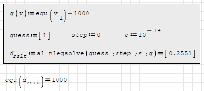

It looks like the outcome isn't correct. If I check the equation with d=0.2551 it doesn't correspond with the equation?

step is max solving steps of al_nleqsolve(), zero means unlimited steps.
guess is a starting point for variable. eps is tolerance for solver.
You can read more about al_nleqsolve() function from Reference Book.
f(d) is common usage of function, not necessary.
Just added for correspondence for functions help sheet.
Can be written as this too, but g(v)=f(v1) is necessary.
i means imaginary number if (-1)^(1/2).
Fourth power of all solutions of d makes function zero.
NaN actually in your case, division by zero.
But numeric solver takes this as a result I guess.
It is correct, check more carefully.

Maple collects all possible solutions, including pure imaginary.
Best respond is the solve(,,,,) bloc, just real intersections.
Thanks for your explanation, some things are strange to me a bit:
1. How can I setup such a grey block as you did?
2. eps should be the tolerance for the solver, I change it to for example to 10 (instead of 14), but the outcome didn't change anyway?
3. Why isn't the jacobi matrix used in the al_nleqsolve()?
4. What does g(v):=f(v1) mean?
Quote
Where is the value of 1000 based on in this equation? I doesn't see the reference?
Quote
I can't follow along with the maple(solve) function yet, why does it end up with 6 values?
Where could I find the reference book? I think I found it within Smath itself as a plugin but couldn't find the topic about al_nleqsolve().
It is just an empty text region placed under the equations. Check the file NoRealRootsError_solved_v2.sm (14.01 KiB) downloaded 1062 time(s)..
It relates decimal accuracy, 10^14 means it will numerically check solvers epsilon till it won't change for 10^14 digits.
Sometimes you need Jacobian matrix sometimes you don't.
It is how it is used in al_nleqsolve(). v is gathered from guess matrix. v1 is first element of guess matrix.
If a system of two unknown would be solved than it will be used as in Reference Book.
5. Where is the value of 1000 based on in this equation? I doesn't see the reference?
1000 is used instead of your 400*10^6, just to show solver is finding results correctly.
6. I can't follow along with the maple(solve) function yet, why does it end up with 6 values?
maple plugin is more capable than SMath's other functions at certain areas, sometimes it can find more results.
It is much more reliable at symbolic results for example.
7. Where could I find the reference book? I think I found it within Smath itself as a plugin but couldn't find the topic about al_nleqsolve().
Check the video below.

3. What is the reason this function is used? What does that 0.2551 value say to me?
this function finds x value which makes equ(x) is equal to 1000.
solve(), roots(), FindRoots() etc could be used too.
I used it just to show you smath can solve your function, correctly.
