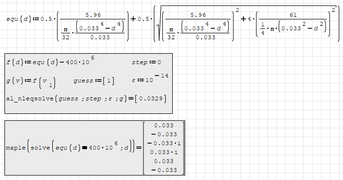

Sorry, coming back on this. What is the meaning of 0.033*i? I can't see what in the end is the solution to d?

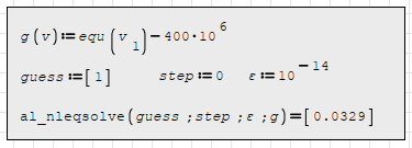

step is max solving steps of al_nleqsolve(), zero means unlimited steps.
guess is a starting point for variable. eps is tolerance for solver.
You can read more about al_nleqsolve() function from Reference Book.
i means imaginary number if (-1)^(1/2).
Fourth power of all solutions of d makes function zero.
NaN actually in your case, division by zero.
But numeric solver takes this as a result I guess.

Maple collects all possible solutions, including pure imaginary.
Best respond is the solve(,,,,) bloc, just real intersections.

2. eps should be the tolerance for the solver, I change it to for example to 10 (instead of 14), but the outcome didn't change anyway?
It relates decimal accuracy, 10^14 means it will numerically check solvers epsilon till it won't change for 10^14 digits.

4. What does g(v):=f(v1) mean?
It is how it is used in al_nleqsolve(). v is gathered from guess matrix. v1 is first element of guess matrix.
If a system of two unknown would be solved than it will be used as in Reference Book.

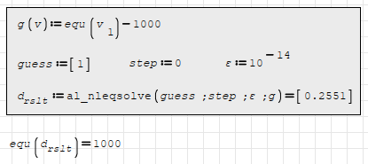

5. Where is the value of 1000 based on in this equation? I doesn't see the reference?
1000 is used instead of your 400*10^6, just to show solver is finding results correctly.
6. I can't follow along with the maple(solve) function yet, why does it end up with 6 values?
maple plugin is more capable than SMath's other functions at certain areas, sometimes it can find more results.
It is much more reliable at symbolic results for example.

3. What is the reason this function is used? What does that 0.2551 value say to me?
this function finds x value which makes equ(x) is equal to 1000.
solve(), roots(), FindRoots() etc could be used too.
I used it just to show you smath can solve your function, correctly.
