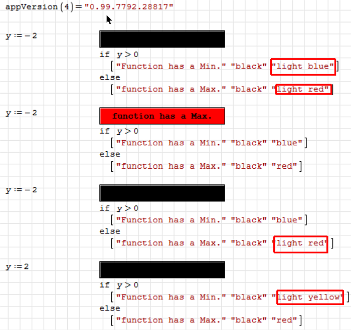

Hi Andrey!
Problems with Formatted Label.
Apparently, it occurs when both text and background color is specified with "light ..." as shown.

Hi Andrey!
To overcome this issue you need to remove spaces from color name (" "). I will fix this.
Thank you!

Hi Andrey!
Thank you!
In the meantime I've added a workaround in the plugin.
This workaround will not work.
You need to change line
SMath.Drawing.Graphics.GetColorByName(color.Replace(" ","");
with
SMath.Drawing.Graphics.GetColorByName(TermsConverter.DecodeText(color));
This is because variable color contains value from Term where text is always encoded. While GetColorByName does not except encoded values.
In case you want to see an example: I did the same correction in the Plot Region plug-in in my latest commit in main repo.
