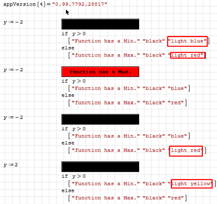

Hi Andrey!
Problems with Formatted Label.
Apparently, it occurs when both text and background color is specified with "light ..." as shown.
Andrey Ivashov 5/2/2021 2:28:00 PM

Hi Andrey!
To overcome this issue you need to remove spaces from color name (" "). I will fix this.
Thank you!
In the meantime I've added a workaround in the plugin.

Hi Andrey!
Thank you!
This workaround will not work.
You need to change line
SMath.Drawing.Graphics.GetColorByName(color.Replace(" ","");
with
SMath.Drawing.Graphics.GetColorByName(TermsConverter.DecodeText(color));
This is because variable color contains value from Term where text is always encoded. While GetColorByName does not except encoded values.
In case you want to see an example: I did the same correction in the Plot Region plug-in in my latest commit in main repo.
