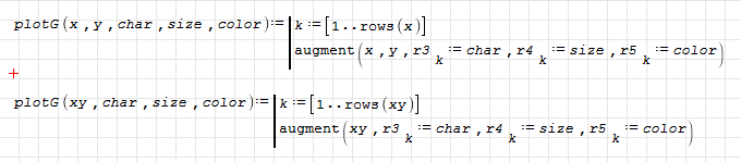

BTW, I would suggest to use another version of plotG which is much faster then previous one (and simplier):
plotG(x,y,char,size,color):line(k:range(1,rows(x)),augment(x,y,el(r3,k):char,el(r4,k):size,el(r5,k):color),2,1)
plotG(xy,char,size,color):line(k:range(1,rows(xy)),augment(xy,el(r3,k):char,el(r4,k):size,el(r5,k):color),2,1)

#32 Posted: 2018/2/16 16:45:48
2,340 likes in 4,041 posts.
I don't replace plotG because don't understand very well that syntax.
It is simple - ranged indexes used.
Just take a look at the speed:
#33 Posted: 2018/2/16 16:59:17
1,123 likes in 1,795 posts.
Thanks for the explanation, now I see the speed increment, and I don't think that it could be that big difference before you show it.
But actually the plotG(4) routine was which confuse me. I prefer
plotG(xy,char,size,color):if(cols(xy)>1,plotG(col(xy,1),col(xy,2),char,size,color),plotG(Re(xy),Im(xy),char,size,color))
because I think that any good plot implementation must to use complexes but not couple of reals. So, if xy argument have only one column, one can assume that data are as Z = X + iY.

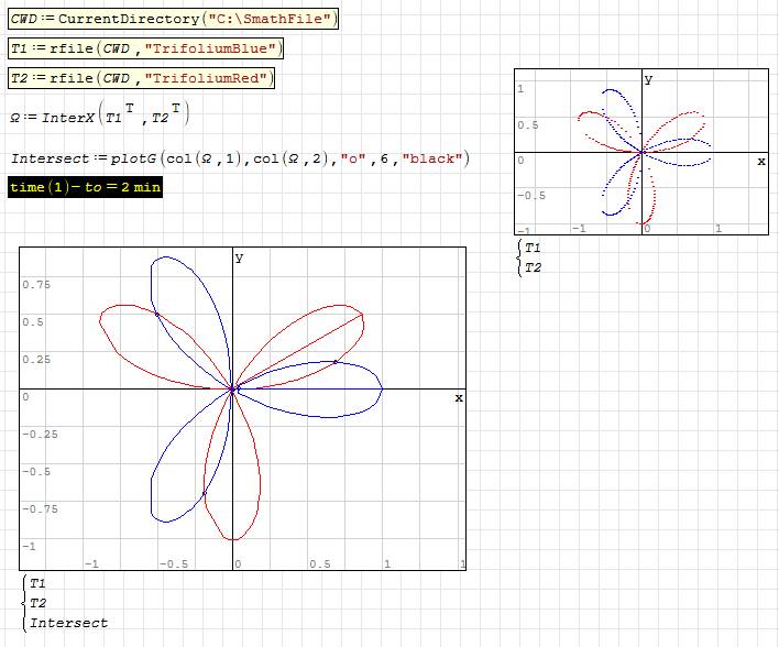

#39 Posted: 2018/2/18 22:58:48
Hello Marco,
I'm trying for the intersection of the two Trifolium, .
blue => native ... red => rotated.
They are created in "Page1 Trifolium.sm
Then recalled for the InterX(T1,T2)
Nothing happens >>> 1 hr ? [Win 7 Starter Edition ... 1.66 GHz]
Is it supposed to work ? Thanks in advance.
Page1 Trifolium.sm (32.5 KiB) downloaded 1275 time(s).
Maths InterseX [Marco].sm (51.7 KiB) downloaded 851 time(s).
#40 Posted: 2018/2/19 00:26:16
Hi Jean.
You are using an old version of the program. Try this one.
Notice that the point (0,0) is found several times by the algorithm. It could be interesting to check if it get the correct number of crosses at the origin.
InterX.r1 - ranged indices_alyles.sm (88.24 KiB) downloaded 1030 time(s).
