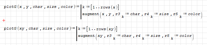

#30 Опубликовано: 16.02.2018 15:49:26
Группа: Super Administrator
BTW, I would suggest to use another version of plotG which is much faster then previous one (and simplier):
plotG(x,y,char,size,color):line(k:range(1,rows(x)),augment(x,y,el(r3,k):char,el(r4,k):size,el(r5,k):color),2,1)
plotG(xy,char,size,color):line(k:range(1,rows(xy)),augment(xy,el(r3,k):char,el(r4,k):size,el(r5,k):color),2,1)
Davide Carpi 16.02.2018 20:54:00

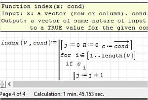

Hi. Just one more thing, I guess: the only one remaining matlab function, mwfind replaced. (Orignal work have many) If I'm not wrong, it is now 100% SMath native. But double the amazing time obtained by Davide. But it's just a "scalar" implementation, sure there are better ones.
PD: I don't replace plotG because don't understand very well that syntax.
InterX.r1 - ranged indices.sm (90,75 КиБ) скачан 1191 раз(а).
It is simple - ranged indexes used.
Just take a look at the speed:
#33 Опубликовано: 16.02.2018 16:59:17
Thanks for the explanation, now I see the speed increment, and I don't think that it could be that big difference before you show it.
But actually the plotG(4) routine was which confuse me. I prefer
plotG(xy,char,size,color):if(cols(xy)>1,plotG(col(xy,1),col(xy,2),char,size,color),plotG(Re(xy),Im(xy),char,size,color))
because I think that any good plot implementation must to use complexes but not couple of reals. So, if xy argument have only one column, one can assume that data are as Z = X + iY.

#35 Опубликовано: 16.02.2018 18:24:21
Arie
Arie
Here's my pure SMATH find function. with similar time to MWFIND.
InterX.r1 - ranged indices_alyles.sm (94,58 КиБ) скачан 1235 раз(а).
Andrey Ivashov 16.02.2018 18:41:00, sergio 17.02.2018 06:31:00, Davide Carpi 16.02.2018 20:57:00, Alvaro 16.02.2018 22:03:00

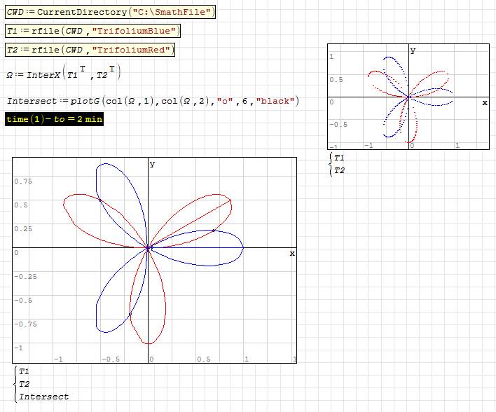

#39 Опубликовано: 18.02.2018 22:58:48
Hello Marco,
I'm trying for the intersection of the two Trifolium, .
blue => native ... red => rotated.
They are created in "Page1 Trifolium.sm
Then recalled for the InterX(T1,T2)
Nothing happens >>> 1 hr ? [Win 7 Starter Edition ... 1.66 GHz]
Is it supposed to work ? Thanks in advance.
Page1 Trifolium.sm (32,5 КиБ) скачан 1475 раз(а).
Maths InterseX [Marco].sm (51,7 КиБ) скачан 1008 раз(а).
#40 Опубликовано: 19.02.2018 00:26:16
Hi Jean.
You are using an old version of the program. Try this one.
Notice that the point (0,0) is found several times by the algorithm. It could be interesting to check if it get the correct number of crosses at the origin.
InterX.r1 - ranged indices_alyles.sm (88,24 КиБ) скачан 1192 раз(а).
