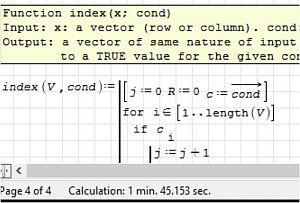

#24 Posted: 2/16/2018 12:31:14 PM
2,343 likes in 4,056 posts.
Hi Marco. Here some comments about your great file. As you suggest, I play with it.
1 min 53 sec on my windows tablet pc.

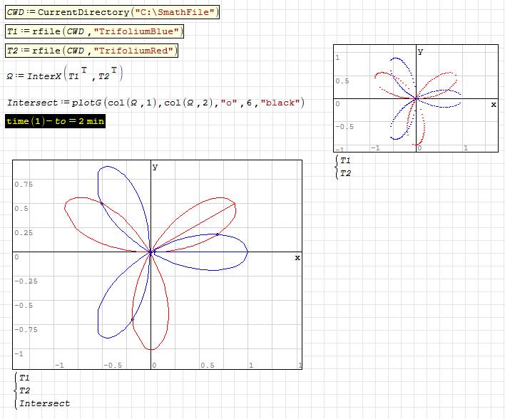

SMath Studio 0.99.6611time(0)-to =83.735 son my windows10
Time taken in my win 10 laptop with SS 0.99.6619 shown.

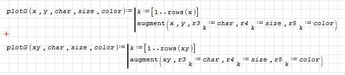

#30 Posted: 2/16/2018 3:49:26 PM
BTW, I would suggest to use another version of plotG which is much faster then previous one (and simplier):
plotG(x,y,char,size,color):line(k:range(1,rows(x)),augment(x,y,el(r3,k):char,el(r4,k):size,el(r5,k):color),2,1)
plotG(xy,char,size,color):line(k:range(1,rows(xy)),augment(xy,el(r3,k):char,el(r4,k):size,el(r5,k):color),2,1)
Davide Carpi 2/16/2018 8:54:00 PM
#31 Posted: 2/16/2018 4:18:55 PM
1,139 likes in 1,805 posts.
Hi. Just one more thing, I guess: the only one remaining matlab function, mwfind replaced. (Orignal work have many) If I'm not wrong, it is now 100% SMath native. But double the amazing time obtained by Davide. But it's just a "scalar" implementation, sure there are better ones.
PD: I don't replace plotG because don't understand very well that syntax.
InterX.r1 - ranged indices.sm (90.75 KiB) downloaded 1191 time(s).
#32 Posted: 2/16/2018 4:45:48 PM
It is simple - ranged indexes used.
Just take a look at the speed:

#35 Posted: 2/16/2018 6:24:21 PM
Arie
Arie
94 likes in 285 posts.
Here's my pure SMATH find function. with similar time to MWFIND.
InterX.r1 - ranged indices_alyles.sm (94.58 KiB) downloaded 1235 time(s).

#39 Posted: 2/18/2018 10:58:48 PM
Hello Marco,
I'm trying for the intersection of the two Trifolium, .
blue => native ... red => rotated.
They are created in "Page1 Trifolium.sm
Then recalled for the InterX(T1,T2)
Nothing happens >>> 1 hr ? [Win 7 Starter Edition ... 1.66 GHz]
Is it supposed to work ? Thanks in advance.
Page1 Trifolium.sm (32.5 KiB) downloaded 1475 time(s).
Maths InterseX [Marco].sm (51.7 KiB) downloaded 1008 time(s).
#40 Posted: 2/19/2018 12:26:16 AM
Hi Jean.
You are using an old version of the program. Try this one.
Notice that the point (0,0) is found several times by the algorithm. It could be interesting to check if it get the correct number of crosses at the origin.
InterX.r1 - ranged indices_alyles.sm (88.24 KiB) downloaded 1192 time(s).
