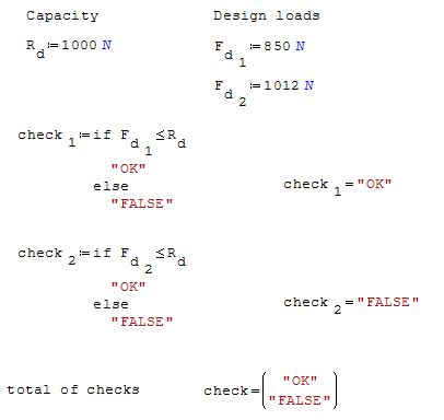

I use most of the time a very simple "if" condition.
No need for plug-ins and very easy to check for any reader.
By using indices you can also create a "table" with all "OK" an "FALSE" results. This can be convenient if you have different load cases with each one or more checks in a large document.
See the attached image.
Hope it is usefull for you!
Regards, csb.
Regards, csb.
