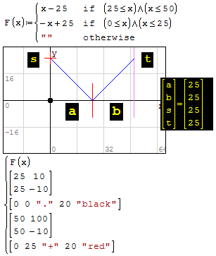

#5 Posted: 2019/10/13 23:00:11
What am I missing here ?
You are missing to plot the literal demo diagram,
here is as per your inputs [a,b,s,t].
More is missing from incomplete project description.
Reflection [abst].sm (62.14 KiB) downloaded 460 time(s).
#6 Posted: 2019/10/14 11:27:00
Refreshed from your literal inputs.
You may have to revisit your College Physics book.
Cheers ... Don't hesitate.
Reflection [abst].sm (128.95 KiB) downloaded 444 time(s).
