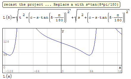

Oh ! ... your proposal is not much productive, is it ?
The picture is strictly discontinuous.

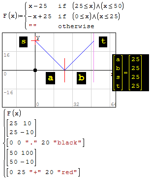

You are missing to plot the literal demo diagram,
here is as per your inputs [a,b,s,t].
More is missing from incomplete project description.
Reflection [abst].sm (62,14 КиБ) скачан 913 раз(а).
Refreshed from your literal inputs.
You may have to revisit your College Physics book.
Cheers ... Don't hesitate.
Reflection [abst].sm (128,95 КиБ) скачан 897 раз(а).

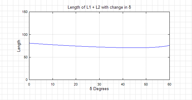

Yes the length L is continuous with respect to ddegrees. I think Jean misunderstands the question. See attached. (A little sloppy but it works)
Edit: Updated graph to add labels
Edit2: Had an error in definition of L. Fixed.
Reflection_alyles.sm (177,77 КиБ) скачан 1180 раз(а).

FYI Jean you're using one of my earlier files where I had a copy paste error in the derivation of L(d), the second root term should only have s*tan(d*pi/180). You can get rid of the "c-"
