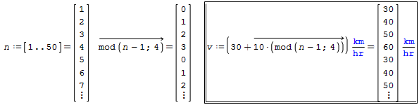

The procedure is to get a vector of the potential values which can then be accessed by index.
You also could implement it as a function v(n) = 30 + mod(n-1, 4)*10

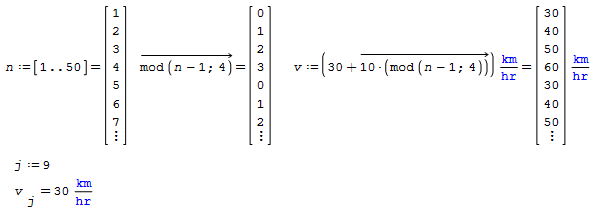

#5 Posted: 2024/3/12 18:51:40
Alex Costila
Alex Costila
1 likes in 13 posts.
Great it works now. I just have to figure it out how to implement it for the rest of the file .

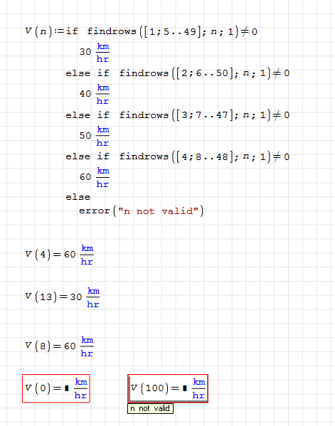

If you have a limited set of choiches, this might be a solution.
Also, I think Martin has a point, since these "n" values should come from some formula.

If there is no rule, then you have to provide a vector with values and adress it with index n. A simple lookup table by index. Fill the vector by hand, by reading a file or asking a chatbot.
