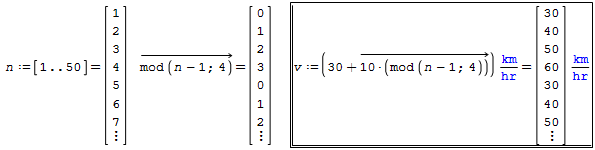

The procedure is to get a vector of the potential values which can then be accessed by index.
You also could implement it as a function v(n) = 30 + mod(n-1, 4)*10
Great it works now. I just have to figure it out how to implement it for the rest of the file .
Thank you very much!

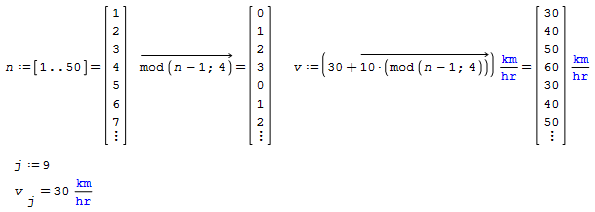

If you have a limited set of choiches, this might be a solution.
Also, I think Martin has a point, since these "n" values should come from some formula.
This works but i have other areas with diferent increment and i can't control them with interval. I will list a few of them:
here is 1,2,3 then goes to 16,17,18 then 26,27,28.
So i have this interval from the picture above and the one before with "Latimea benzii".
