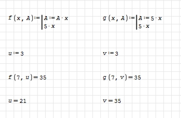

I am expecting the global variable value to change and maintain the change after exiting the function.
Example

Hi. The only way I know for a function to modify a variable is to pass it by reference to the function.

Thank you for your reply. How do I do that? Could you share some sample.
#4 Posted: 2021/7/1 00:12:28
1,123 likes in 1,795 posts.
Hi.
example_by_ref.sm (4.86 KiB) downloaded 1069 time(s).

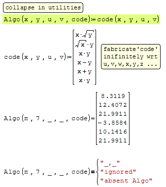

#5 Posted: 2021/7/1 08:35:00
Native Smath has the exceptional feature of being algo style.
You can do what you want from in-situ command line.
Oscar Campo 2021/7/1 10:50:00
