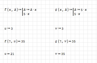

I am expecting the global variable value to change and maintain the change after exiting the function.

Hi. The only way I know for a function to modify a variable is to pass it by reference to the function.
#3 Posted: 7/1/2021 12:03:51 AM
stephen16
stephen16
0 likes in 2 posts.
Hi Alvaro,
Thank you for your reply. How do I do that? Could you share some sample.
#4 Posted: 7/1/2021 12:12:28 AM
1,134 likes in 1,805 posts.
Hi.
example_by_ref.sm (4.86 KiB) downloaded 1221 time(s).

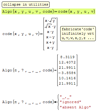

#5 Posted: 7/1/2021 8:35:00 AM
Native Smath has the exceptional feature of being algo style.
You can do what you want from in-situ command line.
Oscar Campo 7/1/2021 10:50:00 AM
