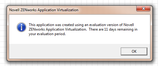

Hi Andrey,
I am getting a Novell ZENworks Application Virtualization Popup when running Smath
version 0.96 (build 4868). It is informing me that there are only 11 days left before the trial expires.
Louis

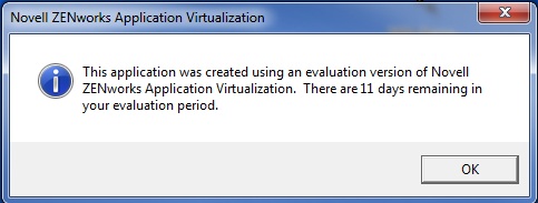

#2 Posted: 2013/6/19 09:34:35
1,435 likes in 2,913 posts.
Confirmed (SMath Studio 0.96.4868 portable)
regards,
Davide
#3 Posted: 2013/6/19 10:25:36
1,308 likes in 2,221 posts.
I confirm that with 4868.
With 4875 and following builds, there is no such problem.

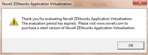

#8 Posted: 2013/7/1 08:20:59
Expired
Only to mention it, the same problem appears in the 0.96.4883 portable.
regards
Davide
