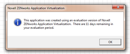

Hi Andrey,
I am getting a Novell ZENworks Application Virtualization Popup when running Smath
version 0.96 (build 4868). It is informing me that there are only 11 days left before the trial expires.
Louis

#3 Опубликовано: 19.06.2013 10:25:36
I confirm that with 4868.
With 4875 and following builds, there is no such problem.

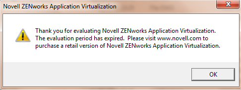

#8 Опубликовано: 01.07.2013 08:20:59
Expired
Only to mention it, the same problem appears in the 0.96.4883 portable.
regards
Davide
