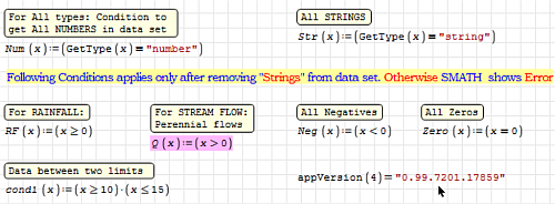

Attached file may be useful in handling data, where it may be
necessary to extract numerical values removing any strings, or
negative values, zeros etc.
Data Analysis Using Truth Table.sm (78.91 KiB) downloaded 1260 time(s).

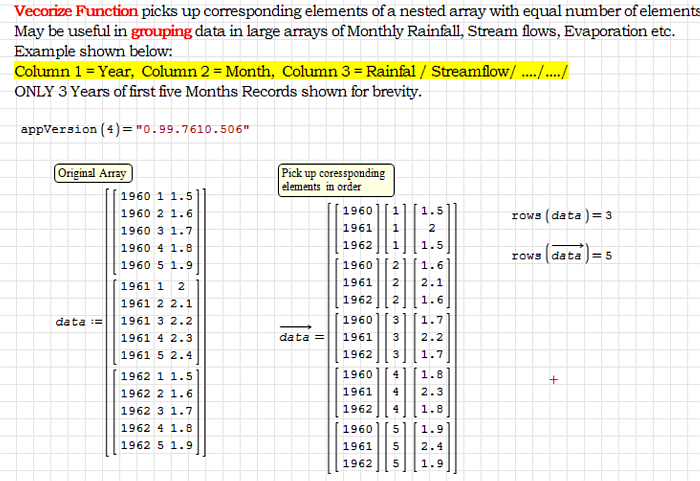

Advantage of vectorize function revisited.
Another practical example attached, with extensive use of the vectorize function. No loops used.
Comments by Martin, Jean, Razonar and others on this subject much appreciated.
Hope this may be useful for beginners.

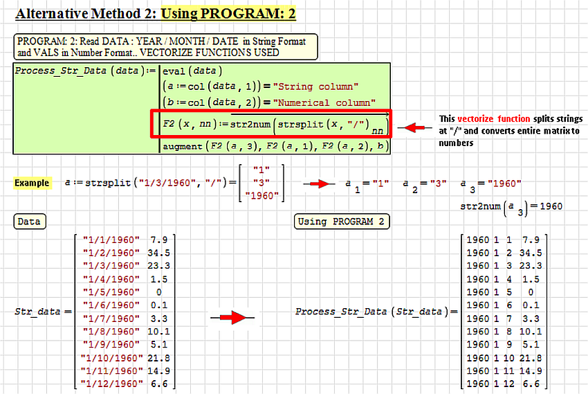

#7 Posted: 2020/4/14 09:04:19
Thanks for the *.PDF ... superb quality !
#8 Posted: 2020/11/12 03:56:59
NDTM Amarasekera
NDTM Amarasekera
130 likes in 352 posts.
I have found this useful in day to day work.
Data imported from MS Excel sheet, and using "findrows" function to sum daily data to monthly totals.
sergio 2020/11/12 05:23:00
#9 Posted: 2020/11/16 14:13:48
NDTM Amarasekera
NDTM Amarasekera

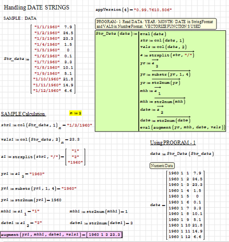

Attached is a simplified version of a project work for demonstration only.
The data file consists of date strings, and hence, had to be transformed into numeric.
Hope this may be useful for beginners. Vectorize function very useful in this exercise.
Handling DATE STRINGS.sm (16.17 KiB) downloaded 1244 time(s).
sergio 2020/11/17 14:39:00
#10 Posted: 2020/11/16 20:48:19
The secret is inside your nice piece of work ... superb, thanks.
Take care my Friend ... Jean
#11 Posted: 2020/11/16 23:58:06
1,123 likes in 1,795 posts.
Hi. Handling data strings you have also this cheat for convert dates to numeric matrices.
Handling DATE STRINGS.sm (20.56 KiB) downloaded 1200 time(s).

#12 Posted: 2020/11/17 01:41:25
NDTM Amarasekera
NDTM Amarasekera
Thank you Jean for your kind words and encouragements. Take care.
Thank you Razonar for the superb alternative. Take care.

#14 Posted: 2021/2/2 04:35:43
NDTM Amarasekera
NDTM Amarasekera
Revised program to handle date strings.
Handling DATE STRINGS+Alvaro.sm (43.62 KiB) downloaded 1240 time(s).
Alvaro 2021/2/2 15:35:00

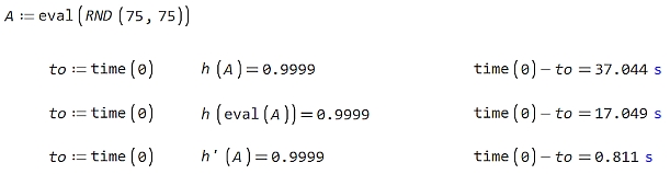

Hi Amarasekera. Yes, that one, thanks. The fact you're showing despite to me about the speed in procedures with arrays. In the attached some comments about the need to redefining M:=M where M is a matrix argument in a procedure.
EvalTest.sm (17.47 KiB) downloaded 1207 time(s).
EvalTest.pdf (73.82 KiB) downloaded 633 time(s).

#18 Posted: 2021/2/2 19:26:52
Ruben Sidranski
Ruben Sidranski
17 likes in 465 posts.
Alvaro,
Are you showing that by redefining Mo variable, within the program, it speeds it up 30 fold? That makes no sense
The only thing that remotely comes to mind is that M, being defined within the program structure as M:=Mo, is not having to read for the variable from the outside.
Have you, or anyone else, tried this on other programs?
#19 Posted: 2021/2/2 19:54:30
Alvaro,
Yes. Please, try to check in your environment if this is true also. (Notice that my laptop is very slow, because always is running something else or overloaded by some other procedures)
Yes. For this was the issue in the original Amarasekera work, and why I say that he was the first showing this behavior. But I have other codes where using M:=M speed up slow procedures. Actually anything with a loop over a matrix.
Here intermediate timing result, which I can't explain
