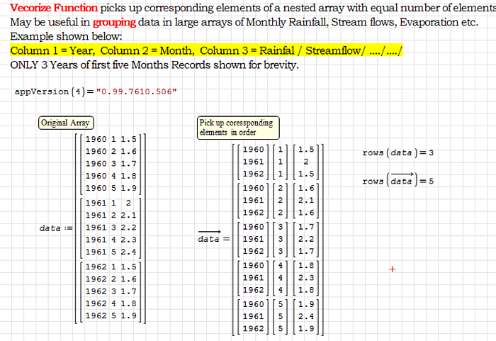

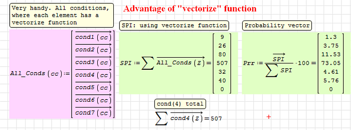

On the request of a fellow Engineer, the attached SM program was developed
to find the Standardized Precipitation Index (SPI).
58 years of daily precipitation data was available.
The SPI is widely used to analyze meteorological drought on a range of
time scales. There are proprietary software packages for this purpose.
The “vectorize” function was pretty handy and fast in analyzing various conditions.
SPI_cal-Rev & Improved-Final.sm (1,92 МиБ) скачан 1478 раз(а).
Rainfal_Data.xlsx (486,22 КиБ) скачан 1109 раз(а).
Radovan Omorjan 06.07.2019 04:23:00, frapuano 06.07.2019 05:13:00, Davide Carpi 06.07.2019 11:20:00

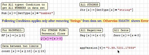

Attached file may be useful in handling data, where it may be
necessary to extract numerical values removing any strings, or
negative values, zeros etc.
Maybe more or otherwise in there.

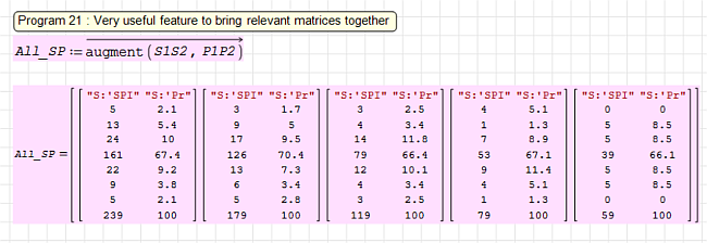

#4 Опубликовано: 13.04.2020 13:20:47
NDTM Amarasekera
NDTM Amarasekera
Advantage of vectorize function revisited.
Another practical example attached, with extensive use of the vectorize function. No loops used.
Comments by Martin, Jean, Razonar and others on this subject much appreciated.
Hope this may be useful for beginners.
Cheers
SPI_cal-Millawana_Multiple_R5.sm (178,1 КиБ) скачан 1401 раз(а).
rainfall_KalaOyaBAsin.xlsx (585,15 КиБ) скачан 1066 раз(а).

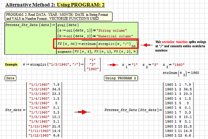

#8 Опубликовано: 12.11.2020 03:56:59
NDTM Amarasekera
NDTM Amarasekera
I have found this useful in day to day work.

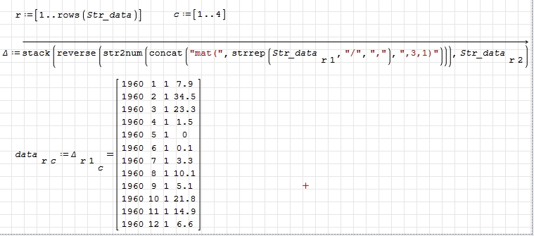

Data imported from MS Excel sheet, and using "findrows" function to sum daily data to monthly totals.
sergio 12.11.2020 05:23:00

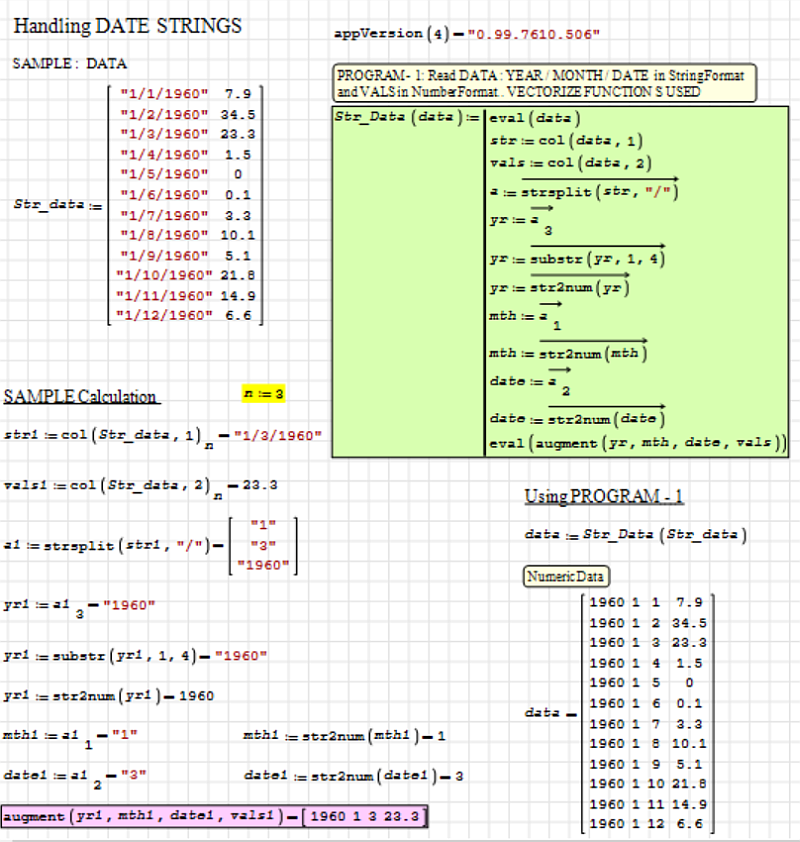

#9 Опубликовано: 16.11.2020 14:13:48
NDTM Amarasekera
NDTM Amarasekera
Attached is a simplified version of a project work for demonstration only.
The data file consists of date strings, and hence, had to be transformed into numeric.
Hope this may be useful for beginners. Vectorize function very useful in this exercise.
Handling DATE STRINGS.sm (16,17 КиБ) скачан 1387 раз(а).
sergio 17.11.2020 14:39:00
#10 Опубликовано: 16.11.2020 20:48:19
The secret is inside your nice piece of work ... superb, thanks.
Take care my Friend ... Jean
#11 Опубликовано: 16.11.2020 23:58:06
Hi. Handling data strings you have also this cheat for convert dates to numeric matrices.
Handling DATE STRINGS.sm (20,56 КиБ) скачан 1339 раз(а).
sergio 17.11.2020 14:39:00, NDTM Amarasekera 17.11.2020 22:29:00
#12 Опубликовано: 17.11.2020 01:41:25
NDTM Amarasekera
NDTM Amarasekera
Thank you Jean for your kind words and encouragements. Take care.
Thank you Razonar for the superb alternative. Take care.
#13 Опубликовано: 17.11.2020 09:44:04
You too Alvaro: take care, thanks ... Jean
#14 Опубликовано: 02.02.2021 04:35:43
NDTM Amarasekera
NDTM Amarasekera
Revised program to handle date strings.
Handling DATE STRINGS+Alvaro.sm (43,62 КиБ) скачан 1391 раз(а).
Alvaro 02.02.2021 15:35:00

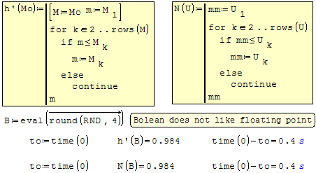

#16 Опубликовано: 02.02.2021 15:44:06

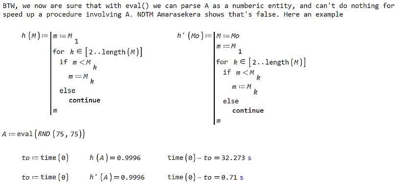

Hi Amarasekera. Yes, that one, thanks. The fact you're showing despite to me about the speed in procedures with arrays. In the attached some comments about the need to redefining M:=M where M is a matrix argument in a procedure.
EvalTest.sm (17,47 КиБ) скачан 1373 раз(а).
EvalTest.pdf (73,82 КиБ) скачан 735 раз(а).
sergio 03.02.2021 06:33:00

#18 Опубликовано: 02.02.2021 19:26:52
Ruben Sidranski
Ruben Sidranski
Alvaro,
Are you showing that by redefining Mo variable, within the program, it speeds it up 30 fold? That makes no sense
The only thing that remotely comes to mind is that M, being defined within the program structure as M:=Mo, is not having to read for the variable from the outside.
Have you, or anyone else, tried this on other programs?
#19 Опубликовано: 02.02.2021 19:54:30
Alvaro,

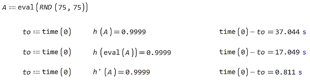

Yes. Please, try to check in your environment if this is true also. (Notice that my laptop is very slow, because always is running something else or overloaded by some other procedures)
Yes. For this was the issue in the original Amarasekera work, and why I say that he was the first showing this behavior. But I have other codes where using M:=M speed up slow procedures. Actually anything with a loop over a matrix.
Here intermediate timing result, which I can't explain
#20 Опубликовано: 02.02.2021 22:13:47
What's wrong or incorrect in there is length it shouldn't exist in Smath
