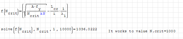

Hello everyone. I have a problem solving this equation. Could anyone help me? Thank You.

Hi lookmar,
use solve(4) instead of solve(2)
