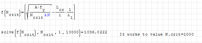

Hello everyone. I have a problem solving this equation. Could anyone help me? Thank You.
critical force.sm (8,82 КиБ) скачан 1379 раз(а).
Hi lookmar,
use solve(4) instead of solve(2)
regards,
w3b5urf3r
