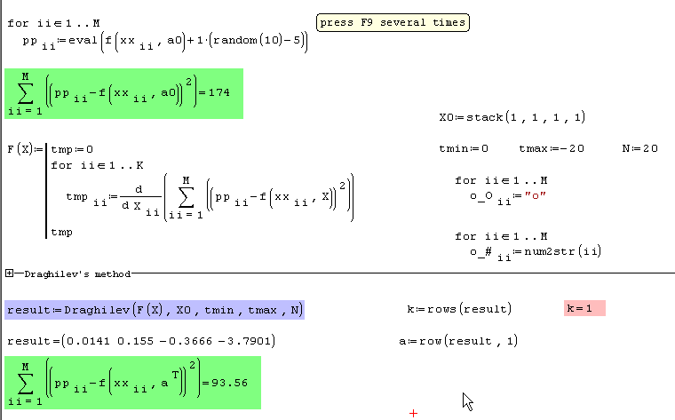

#24 Posted: 2012/10/6 02:24:32
You are right uni, thank you
Now, every F9 produces result for your test problem.
#25 Posted: 2012/10/6 10:06:38
1,554 likes in 1,864 posts.
20 points (~24 sec). I made some little changes in Draghilev() function.
Draghilev's method. NLS. Example 2.smz (6.17 KiB) downloaded 1111 time(s).
Radovan Omorjan 2012/10/6 10:41:00

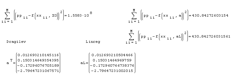

#26 Posted: 2012/10/6 11:02:10
Hello uni,
It is quite interesting that you've made it working with 20 points .
By the way, I've added the sum of squares - just to check how this sum reduces its value.

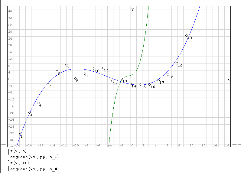

#27 Posted: 2012/10/6 11:17:30
Yes, but initial value for a is X0 := stack(1, 1, 1, 1)
#28 Posted: 2012/10/6 12:20:33
Sorry, uni, my mistake . Graph distracted me
In this example - this is really amazing
If this could work for a bit more complicates functions - it would be really great .

Thank you for considering this . If you include the sum of squares to your example above, then it is equivalent as finding the roots of this three equations
[MATH=eng]sum(((el(pp,i)-f(el(xx,i),a1,a2,a3))*diff((f(el(xx,i),a1,a2,a3)),a1)),i,1,n)≡0[/MATH]
[MATH=eng]sum(((el(pp,i)-f(el(xx,i),a1,a2,a3))*diff((f(el(xx,i),a1,a2,a3)),a2)),i,1,n)≡0[/MATH]
[MATH=eng]sum(((el(pp,i)-f(el(xx,i),a1,a2,a3))*diff((f(el(xx,i),a1,a2,a3)),a3)),i,1,n)≡0[/MATH]
It is a well known and maybe redundant to say, sorry - the first derivatives over three unknowns (a1,a2,a3) should be zero
Now I knew where it came from. I also fixed a bug with double index ii. I've used it twice.
Draghilev's method. NLS. Example 2.1.smz (6.41 KiB) downloaded 1100 time(s).
#31 Posted: 2012/10/7 06:20:29
Hello uni,
It seems very promising
As it is basically a linear regression over parameters (polynomial equation) I just added the result of it - just for checking. The results are very close to each other. It is interesting that the method is working on this problem very well
The determinant [MATH=eng]det((transpose(XX)*XX))=2.40082615642816*10^16[/MATH]is rather far from zero - well conditioned system. I suppose that would be very interesting to see what will happen when this determinant is quite close to zero - ill conditioned system. I suppose that the results must be quite different.

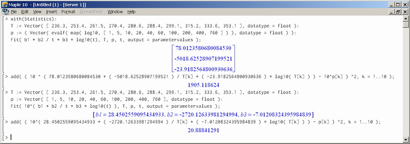

#34 Posted: 2012/10/8 05:42:03
Radovan, it's really hard to get a solution using the Draghilev method. I do not know how to do it yet.
The solution here is: [28.4502559095434933, -2720.12633981294994, -7.01208324395984839]. Maybe later I'll be able to get it.
Davide Carpi 2012/10/9 03:32:00, Radovan Omorjan 2012/10/8 08:02:00

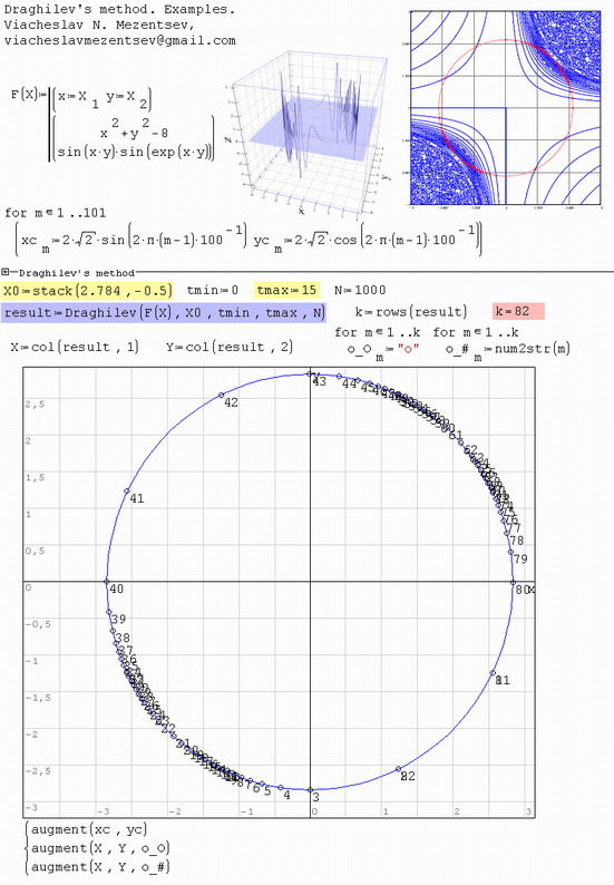

#38 Posted: 2012/10/11 01:01:39
Example 5. Finding roots: System 4.
[MATH]sys(x^2+y^2-8=0;sin(x*y)*sin(exp(x*y))=0;2;1)[/MATH]
I made minor changes to simplify the calculations. Function has become more clear.
Calculation time: ~1.5 min
Roots: 80
Radovan Omorjan 2012/10/11 02:36:00
