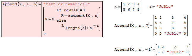

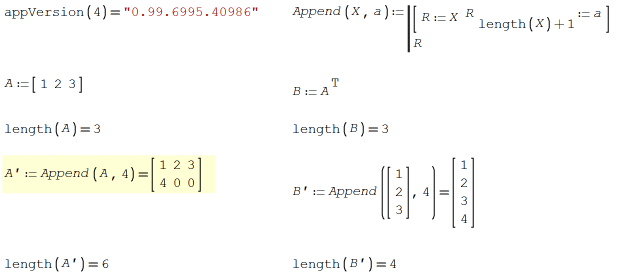

Hi. Is this the expected behavior?
Append.sm (6.87 KiB) downloaded 1235 time(s).
I hope not. I expect A' = [1 2 3 4]

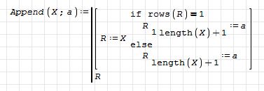

#2 Posted: 2019/2/27 21:32:07
Alvaro: maybe like this ?

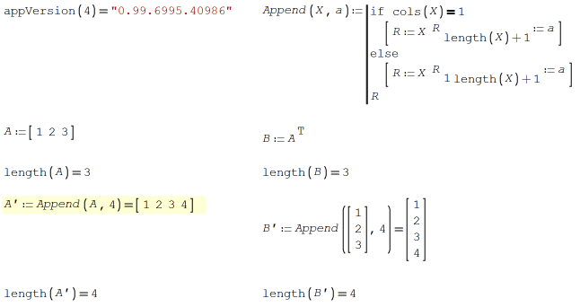

#3 Posted: 2019/2/27 21:53:45
1,123 likes in 1,795 posts.

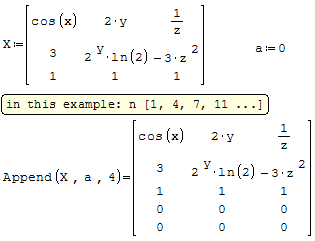

Hi Jean. Nope, maybe more like this:
BTW, this is a workaround. I expect this result but for the previous syntax.

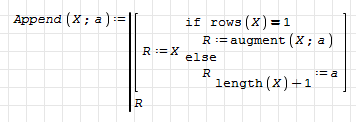

#4 Posted: 2019/2/27 22:20:41
You just append, my code inserts wherever needed.
My mistake I named Append(,,,)
OK, you are imitating MCD.
Simpler Append: transpose the row, stack, re-transpose.

#7 Posted: 2019/2/28 05:48:34
1,443 likes in 2,935 posts.
Yes it is correct, or at least it conforms with the general approach of the program (vectors are single column matrices, anything else is a matrix). You might see it better in a 2 rows matrix:
The new indices are added expanding the matrix vertically; there is no special case for single-row matrices.

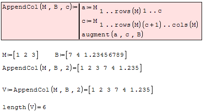

For your task, one way could be this:
Or this:
Thanks for the explain. You give to me the rule for understand the result. Just as comment, matlab don't follow that, and gives this results:
