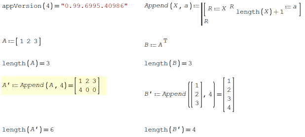

Hi. Is this the expected behavior?
Append.sm (6,87 КиБ) скачан 1399 раз(а).
I hope not. I expect A' = [1 2 3 4]

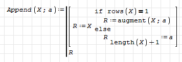

Alvaro: maybe like this ?

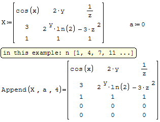

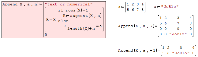

Hi Jean. Nope, maybe more like this:
BTW, this is a workaround. I expect this result but for the previous syntax.

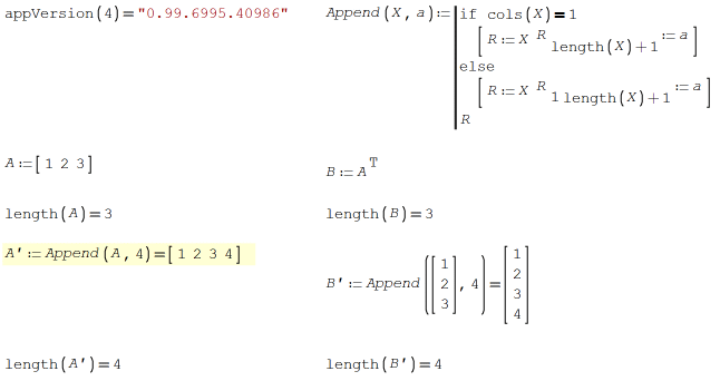

#4 Опубликовано: 27.02.2019 22:20:41
You just append, my code inserts wherever needed.
My mistake I named Append(,,,)
OK, you are imitating MCD.
Simpler Append: transpose the row, stack, re-transpose.

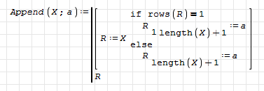

For your task, one way could be this:
Or this:

#8 Опубликовано: 28.02.2019 13:22:34
#9 Опубликовано: 28.02.2019 14:42:13
... append this Jacobian matrix.
