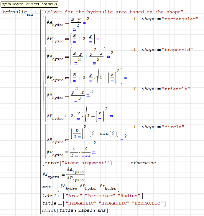

I have two forms of the program in this file. I would be happy
  • Get the program to work
In the file is a snippet of the MathCAD program I was using to confirm the structure
hydraulic radius.sm (213.85 KiB) downloaded 1064 time(s).

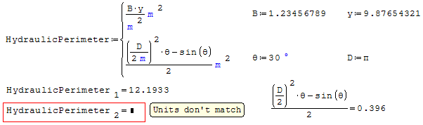

#3 Posted: 2021/1/28 20:24:14
Ruben Sidranski
Ruben Sidranski
17 likes in 465 posts.
Thanks for the attachment. I remember a similar MathCAD file
It bothers me that you cannot open my 0.99.7610 SM files ...

#5 Posted: 2021/1/28 21:25:26
Ruben Sidranski
Ruben Sidranski
I do have a θ per the screenshot above. Issue is in program structure.
Thank you for looking at this.
#6 Posted: 2021/1/28 22:30:56
churichuro
churichuro
29 likes in 79 posts.
hydraulic radius.sm (215.2 KiB) downloaded 1015 time(s).
you have 2 little mistakes
shape must be a string and you are passing it an integer
and second I think that in the functions you should use the assignment (: =)
and not the symbol (=)

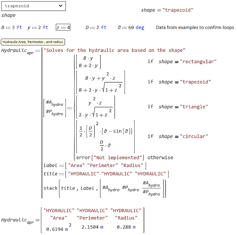

#8 Posted: 2021/1/28 23:05:13
Ruben Sidranski
Ruben Sidranski
@churichurro
I didn't notice that you deleted "continue" in the else part of my file. That was the issue!
"ELSE" needs to start the next "IF" loop, therefore it's nested. I'll clean it up and re-post
#9 Posted: 2021/1/28 23:48:36
Ruben Sidranski
Ruben Sidranski
Anyone have a good description, write-up, or weblink that derives these two formulas? (Not Wikipedia)
As promised above.
This made Manning so much easier. Thank you all
Hydraulic Radius Final.sm (16.32 KiB) downloaded 1006 time(s).
#10 Posted: 2021/1/29 04:07:23
Martin_B
Martin_B
22 likes in 84 posts.
Thats's nearly a prime example for using cases instead of if/else:
#11 Posted: 2021/1/29 07:01:12
1,123 likes in 1,795 posts.
Hi. You don't need to divide by the units in the body of the procedure. Notice that z is the side slope, so it's dimensionless, equal to length / length, even eventually can have units, like mm/m. This is, given that z is the horizontal change per unit vertical change, it's usual to use one unit for horizontal change but another to the vertical change.
I've never heard of or used "cases"
Update, to add "IFs", Jean answered the question: click right hand most place holder, coma twice for one more if... again coma twice like before. Will be dissecting this function. Thanks to others who posted sheets.

#17 Posted: 2021/1/29 11:35:38
Yep. Here with correct units:
Hydraulic Radius Final.sm (15.64 KiB) downloaded 1018 time(s).

#19 Posted: 2021/1/29 12:17:35
Ruben Sidranski
Ruben Sidranski
Alvaro,
I tend to use units wherever and whenever possible. I see what you mean with "z". This IS unitless, thank you for correcting this. I fixed the formula to omit units on my sheet.
I now see the units comment clearly
