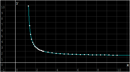

Hola Carlos. This is another approach.
PileRedux_Factor_CBG.sm (115.19 KiB) downloaded 1257 time(s).
PileRedux_Factor_CBG.pdf (376.79 KiB) downloaded 685 time(s).

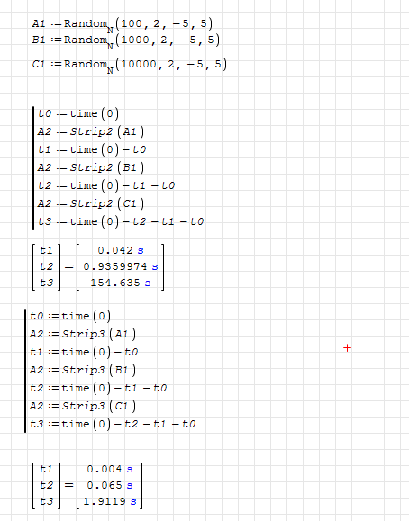

Hi Jean,
See attached. I've modified your strip2() algorithm [See Strip3()]. On my PC it performs same calculations ~10x faster. Might help with large data sets.
PileRedux_Factor_CBG [1]_alyles.sm (31.33 KiB) downloaded 1112 time(s).
Here's some proof of that.

Hi Jean,
Thanks alyles ... Good job !
Hola Alvaro.
Gracias

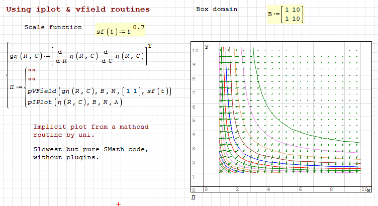

I make the next comment. In none of the 3 graphs that you show,
the scale of the "Y" axis, reaches the value 10, so I think,
it would be necessary to expand the scale to verify that the curves are correct
Carlos

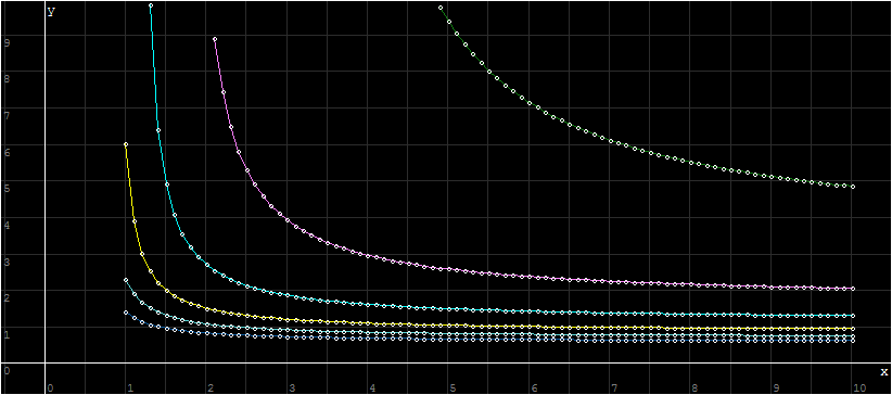

Carlos, the limits are the limits of the solver.
I refactored a bit to understand myself easier,
played a bit the lower limits [A5, A6] ... bingo !
That reminds me how long it toke Mathcad 11 to solve
the Solar Cell project ... let say ~ 1 month.
Page4 Carlos.sm (29.2 KiB) downloaded 1398 time(s).

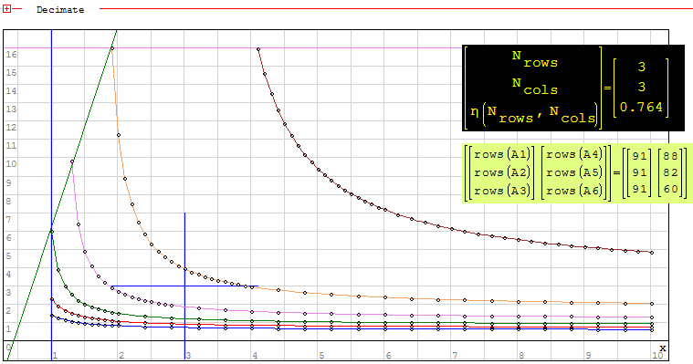

Decimate part of the A1, A2,A3 . Confirm project is valid
particularly withe 'z' target in A solvers.
Project PileRedux_Factor_CBG [1].sm (30.8 KiB) downloaded 1103 time(s).

... I make the next comment. In none of the 3 graphs that you show,
Hola Carlos. Maxima shows 10 for both axis, IPlotSolve, by construction, only can take two vectors (x or y and lambda) but not 3 (x and y and lambda).
For pIPlot and pVField, just change the Box in 'B'. I take columns only one to five.

Hola Carlos,
Few more things to improve presentation ...
... decimated plots are lot more presentable.
At this point, for a specific target solution
easy to get a Thiele analytical formulation.
In the mean time, I will test some decay model.
Project PileRedux_Factor_CBG [1].sm (46.98 KiB) downloaded 1067 time(s).

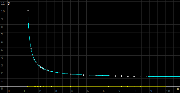

#32 Posted: 2019/3/29 12:42:43
... a pretty good fit. More models to be explored.
Project PileRedux_Factor_CBG [1] Rational Fit.sm (58.08 KiB) downloaded 1099 time(s).
#33 Posted: 2019/3/29 17:40:28
... patience is rewarded, an exact fit
considering the inexact solver solutions.
Project PileRedux_Factor_CBG [1] Exact Homographic.sm (50.54 KiB) downloaded 1084 time(s).
