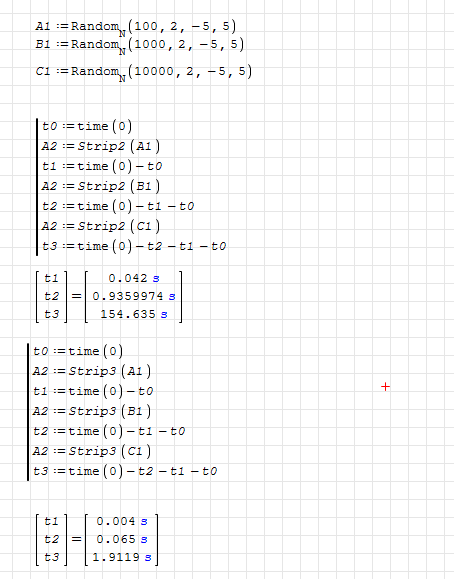

See attached. I've modified your strip2() algorithm [See Strip3()]. On my PC it performs same calculations ~10x faster. Might help with large data sets.

Here's some proof of that.

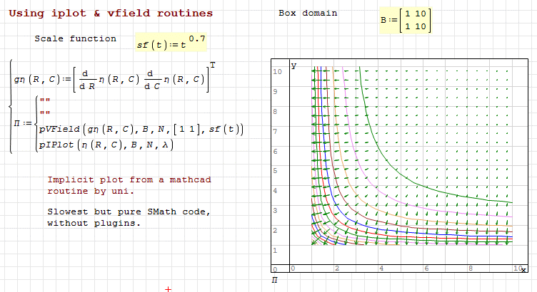

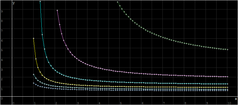

I make the next comment. In none of the 3 graphs that you show,
the scale of the "Y" axis, reaches the value 10, so I think,
it would be necessary to expand the scale to verify that the curves are correct
Carlos

Carlos, the limits are the limits of the solver.
I refactored a bit to understand myself easier,
played a bit the lower limits [A5, A6] ... bingo !
That reminds me how long it toke Mathcad 11 to solve
the Solar Cell project ... let say ~ 1 month.
Page4 Carlos.sm (29,2 КиБ) скачан 1606 раз(а).

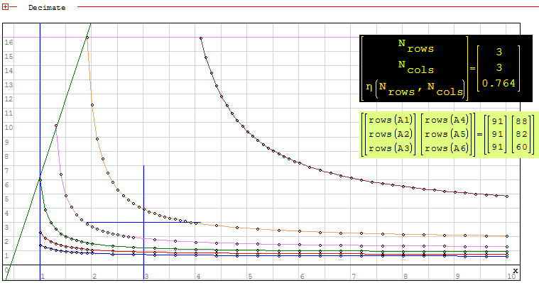

Few more things to improve presentation ...
Decimate part of the A1, A2,A3 . Confirm project is valid

Hola Carlos. Maxima shows 10 for both axis, IPlotSolve, by construction, only can take two vectors (x or y and lambda) but not 3 (x and y and lambda).
For pIPlot and pVField, just change the Box in 'B'. I take columns only one to five.
... decimated plots are lot more presentable.
At this point, for a specific target solution
easy to get a Thiele analytical formulation.

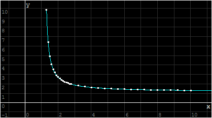

In the mean time, I will test some decay model.
... a pretty good fit. More models to be explored.

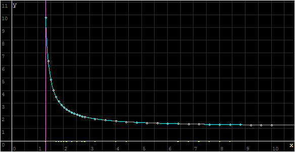

... patience is rewarded, an exact fit
considering the inexact solver solutions.
