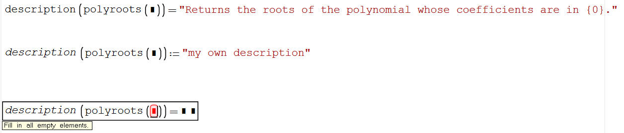

You can add your own description(s) in this way.
![2024-05-22 09_43_01-SMath Solver - [Worksheet1_].png](/zh-Hans-CN/files/Download/HGRymY/2024-05-22-09_43_01-SMath-Solver---[Worksheet1_].png)
If you mean in the description, just right click on the region that holds the definition and change the language on the context menu; you can add a description for each language.
If you want another language to be supported, you have to ask Andrey directly.
Wrotebesides , is it possible to support orther languages?
WroteYou can add your own description(s) in this way.
