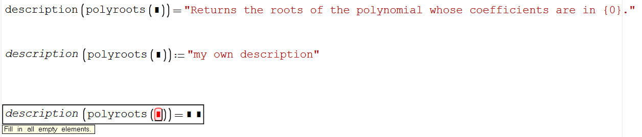

i have tried for example :
but failed .

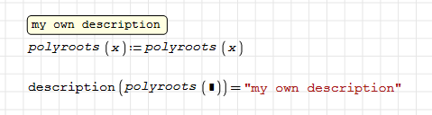

You can add your own description(s) in this way.
besides , is it possible to support orther languages?
If you mean in the description, just right click on the region that holds the definition and change the language on the context menu; you can add a description for each language.

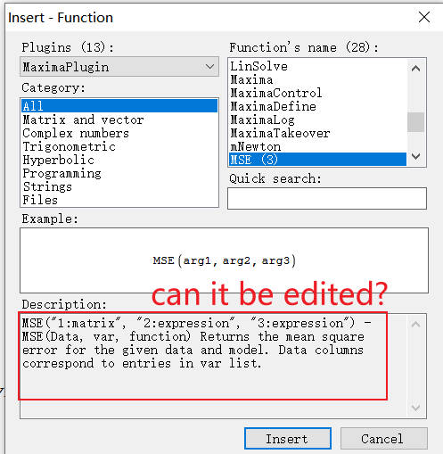

hi,Davide, thanks very much, this method works, but it didn't fully achieve my goal.
what i want is add some note about that function in Function-Description ,
Snipaste_2024-05-22_20-01-34.jpg,
and in the Example field , it didn't give a truly example but a syntax to call that function ,
so i wonder if there a way to add my own description about that function .
thanks.

AFAIK that's not possible. The dialog loads the descriptions stored in the plugins at program startup. Currently the only way would be to recompile the plugin with your own descriptions edited in the source code.
